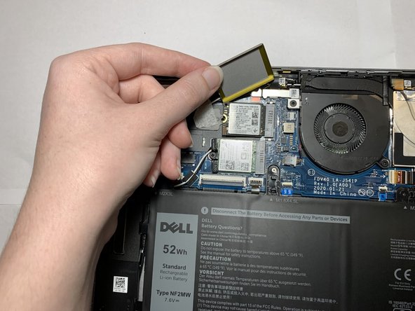

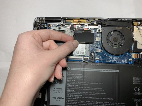

  4. Dell Latitude 9410 2-in-1 SSD Replacement, SSD: crwdns2935265:04crwdnd2935265:01crwdnd2935265:03crwdne2935265:0 Dell Latitude 9410 2-in-1 SSD Replacement, SSD: crwdns2935265:04crwdnd2935265:02crwdnd2935265:03crwdne2935265:0 Dell Latitude 9410 2-in-1 SSD Replacement, SSD: crwdns2935265:04crwdnd2935265:03crwdnd2935265:03crwdne2935265:0
    • Carefully peel back and remove the black tape around the top left corner of the motherboard.

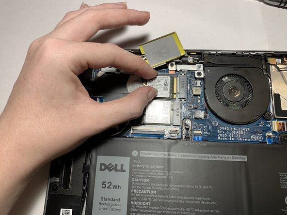

  5. Dell Latitude 9410 2-in-1 SSD Replacement: crwdns2935265:05crwdnd2935265:01crwdnd2935265:03crwdne2935265:0 Dell Latitude 9410 2-in-1 SSD Replacement: crwdns2935265:05crwdnd2935265:02crwdnd2935265:03crwdne2935265:0 Dell Latitude 9410 2-in-1 SSD Replacement: crwdns2935265:05crwdnd2935265:03crwdnd2935265:03crwdne2935265:0
    • Use a Phillips #00 screwdriver to remove the 2 mm screw, loosening the bracket that covers the SSD.
    • Carefully lift the off the bracket.
    • The bracket is attached to the laptop and cannot be removed completely.

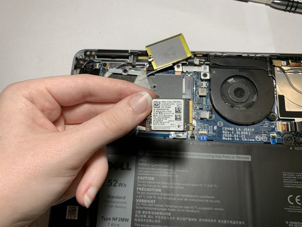

  6. Dell Latitude 9410 2-in-1 SSD Replacement: crwdns2935265:06crwdnd2935265:01crwdnd2935265:03crwdne2935265:0 Dell Latitude 9410 2-in-1 SSD Replacement: crwdns2935265:06crwdnd2935265:02crwdnd2935265:03crwdne2935265:0 Dell Latitude 9410 2-in-1 SSD Replacement: crwdns2935265:06crwdnd2935265:03crwdnd2935265:03crwdne2935265:0
    • Grip the SSD and pull directly backward until the SSD releases from its port.
