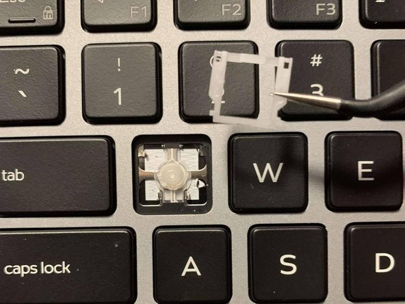

    • Gently insert the edge of the opening tool under the affected key.
    • Lift the key until it reaches a 45 degree angle and releases from the keyboard.
  2. Dell Latitude 9410 2-in-1 Key Replacement: crwdns2935265:02crwdnd2935265:01crwdnd2935265:03crwdne2935265:0 Dell Latitude 9410 2-in-1 Key Replacement: crwdns2935265:02crwdnd2935265:02crwdnd2935265:03crwdne2935265:0 Dell Latitude 9410 2-in-1 Key Replacement: crwdns2935265:02crwdnd2935265:03crwdnd2935265:03crwdne2935265:0
    • Use tweezers to lift and remove the key cap.
    • Use tweezers to remove the plastic retainer clip beneath the key.
  3. Dell Latitude 9410 2-in-1 Key Replacement: crwdns2935265:03crwdnd2935265:01crwdnd2935265:02crwdne2935265:0 Dell Latitude 9410 2-in-1 Key Replacement: crwdns2935265:03crwdnd2935265:02crwdnd2935265:02crwdne2935265:0
    • Use tweezers to remove the square plastic bracket.
