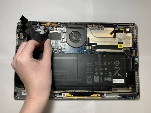

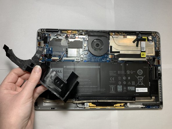

    • Carefully lift off the back panel.
  4. Dell Latitude 9410 2-in-1 Fan Replacement, Fan: crwdns2935265:04crwdnd2935265:01crwdnd2935265:03crwdne2935265:0 Dell Latitude 9410 2-in-1 Fan Replacement, Fan: crwdns2935265:04crwdnd2935265:02crwdnd2935265:03crwdne2935265:0 Dell Latitude 9410 2-in-1 Fan Replacement, Fan: crwdns2935265:04crwdnd2935265:03crwdnd2935265:03crwdne2935265:0

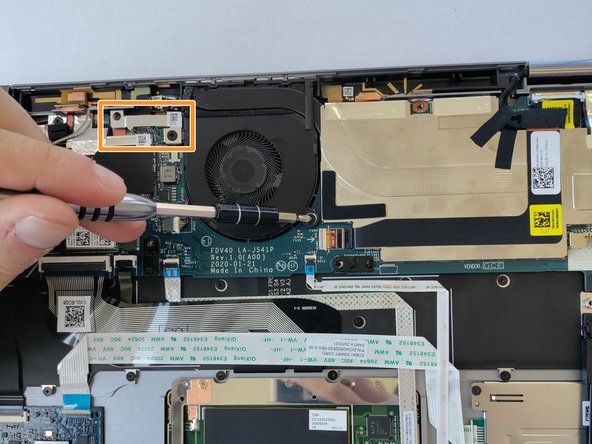

    • Carefully peel back and remove the black tape around the top left corner of the motherboard.
  5. Dell Latitude 9410 2-in-1 Fan Replacement: crwdns2935265:05crwdnd2935265:01crwdnd2935265:02crwdne2935265:0 Dell Latitude 9410 2-in-1 Fan Replacement: crwdns2935265:05crwdnd2935265:02crwdnd2935265:02crwdne2935265:0
    • Use a Philips #00 screwdriver to remove the two 2 mm screws.
    • After the screws are removed, lift off the silver bracket, toward the top left of the fan.

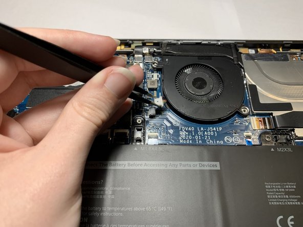

  6. Dell Latitude 9410 2-in-1 Fan Replacement: crwdns2935265:06crwdnd2935265:01crwdnd2935265:02crwdne2935265:0 Dell Latitude 9410 2-in-1 Fan Replacement: crwdns2935265:06crwdnd2935265:02crwdnd2935265:02crwdne2935265:0
    • Grip both sides of the fan connector plug with tweezers, and pull directly backwards, toward the cables, until the plug disconnects.

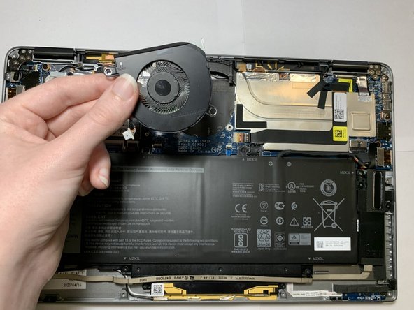

  7. Dell Latitude 9410 2-in-1 Fan Replacement: crwdns2935265:07crwdnd2935265:01crwdnd2935265:02crwdne2935265:0 Dell Latitude 9410 2-in-1 Fan Replacement: crwdns2935265:07crwdnd2935265:02crwdnd2935265:02crwdne2935265:0
    • Lift the fan up and out.
