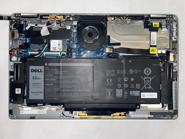

  1. Dell Latitude 9410 2-in-1 Display Replacement, Base Panel: crwdns2935265:01crwdnd2935265:01crwdnd2935265:01crwdne2935265:0
    • Ensure that the laptop is unplugged and powered off before beginning.
    • Place the laptop upside down on a flat surface.
  2. Dell Latitude 9410 2-in-1 Display Replacement: crwdns2935265:02crwdnd2935265:01crwdnd2935265:02crwdne2935265:0 Dell Latitude 9410 2-in-1 Display Replacement: crwdns2935265:02crwdnd2935265:02crwdnd2935265:02crwdne2935265:0
    • Use a Phillips #00 screwdriver to loosen the ten captive screws.
    • The screws are permanently fastened to the base panel; do not attempt to remove them.

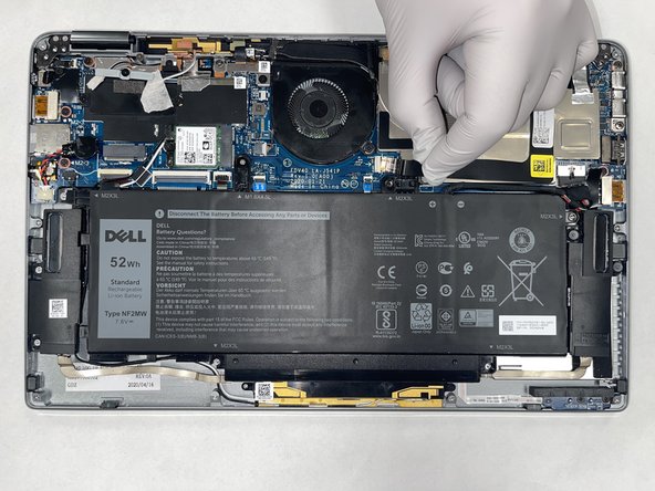

  4. Dell Latitude 9410 2-in-1 Display Replacement, Battery: crwdns2935265:04crwdnd2935265:01crwdnd2935265:02crwdne2935265:0 Dell Latitude 9410 2-in-1 Display Replacement, Battery: crwdns2935265:04crwdnd2935265:02crwdnd2935265:02crwdne2935265:0
    • Use a Philips #00 screwdriver to remove the five 3mm screws that secure the battery.
  5. Dell Latitude 9410 2-in-1 Display Replacement: crwdns2935265:05crwdnd2935265:01crwdnd2935265:03crwdne2935265:0 Dell Latitude 9410 2-in-1 Display Replacement: crwdns2935265:05crwdnd2935265:02crwdnd2935265:03crwdne2935265:0 Dell Latitude 9410 2-in-1 Display Replacement: crwdns2935265:05crwdnd2935265:03crwdnd2935265:03crwdne2935265:0
    • Use a Philips #00 screwdriver to remove one 4.5 mm screw.
  6. Dell Latitude 9410 2-in-1 Display Replacement: crwdns2935265:06crwdnd2935265:01crwdnd2935265:02crwdne2935265:0 Dell Latitude 9410 2-in-1 Display Replacement: crwdns2935265:06crwdnd2935265:02crwdnd2935265:02crwdne2935265:0
    • Grip the battery cable near the plug and pull it straight out, in the direction of the cable.
  7. Dell Latitude 9410 2-in-1 Display Replacement: crwdns2935265:07crwdnd2935265:01crwdnd2935265:02crwdne2935265:0 Dell Latitude 9410 2-in-1 Display Replacement: crwdns2935265:07crwdnd2935265:02crwdnd2935265:02crwdne2935265:0
    • Use tweezers to gently move the speaker ribbon cable away from the bottom of the battery.
    • The ribbon cable is thin and fragile; handle it carefully.
    • The ribbon cable only needs to be moved so that the battery can be removed; do not completely remove the ribbon cable.
  8. Dell Latitude 9410 2-in-1 Display Replacement: crwdns2935265:08crwdnd2935265:01crwdnd2935265:02crwdne2935265:0 Dell Latitude 9410 2-in-1 Display Replacement: crwdns2935265:08crwdnd2935265:02crwdnd2935265:02crwdne2935265:0
    • Lift the battery out with two hands.

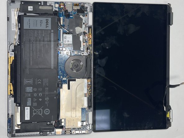

  9. Dell Latitude 9410 2-in-1 Display Replacement, Display: crwdns2935265:09crwdnd2935265:01crwdnd2935265:03crwdne2935265:0 Dell Latitude 9410 2-in-1 Display Replacement, Display: crwdns2935265:09crwdnd2935265:02crwdnd2935265:03crwdne2935265:0 Dell Latitude 9410 2-in-1 Display Replacement, Display: crwdns2935265:09crwdnd2935265:03crwdnd2935265:03crwdne2935265:0
    • Carefully detach the ribbon that is affixed to the HDD.
    • Using a Philips #00 screwdriver, unscrew the 3, top left and top right 4mm screws located about the hinge.
  10. Dell Latitude 9410 2-in-1 Display Replacement: crwdns2935265:010crwdnd2935265:01crwdnd2935265:02crwdne2935265:0 Dell Latitude 9410 2-in-1 Display Replacement: crwdns2935265:010crwdnd2935265:02crwdnd2935265:02crwdne2935265:0
    • Carefully detach the back panel from the screen via the hinges.
