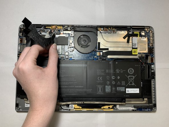

    • Carefully lift off the back panel.
  4. Dell Latitude 9410 2-in-1 CMOS Battery Replacement, CMOS Battery: crwdns2935265:04crwdnd2935265:01crwdnd2935265:03crwdne2935265:0 Dell Latitude 9410 2-in-1 CMOS Battery Replacement, CMOS Battery: crwdns2935265:04crwdnd2935265:02crwdnd2935265:03crwdne2935265:0 Dell Latitude 9410 2-in-1 CMOS Battery Replacement, CMOS Battery: crwdns2935265:04crwdnd2935265:03crwdnd2935265:03crwdne2935265:0
    • Carefully peel back and remove the black tape around the top left corner of the motherboard.
  5. Dell Latitude 9410 2-in-1 CMOS Battery Replacement: crwdns2935265:05crwdnd2935265:01crwdnd2935265:03crwdne2935265:0 Dell Latitude 9410 2-in-1 CMOS Battery Replacement: crwdns2935265:05crwdnd2935265:02crwdnd2935265:03crwdne2935265:0 Dell Latitude 9410 2-in-1 CMOS Battery Replacement: crwdns2935265:05crwdnd2935265:03crwdnd2935265:03crwdne2935265:0
    • Grip the CMOS cable as close as possible to the plug, and gently pull directly backwards, in the direction of the cables, until the CMOS cable disconnects from the motherboard.
    • If the cable is hard to pull out by hand, use tweezers to get a better grip on the cable connector.
