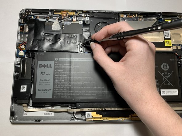

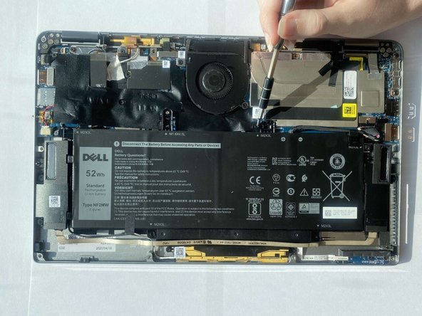

    • Use a Philips #00 screwdriver to remove the five 3mm screws that secure the battery.

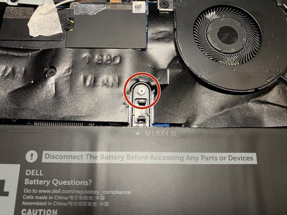

    • Use a Philips #00 screwdriver to remove one 4.5 mm screw.

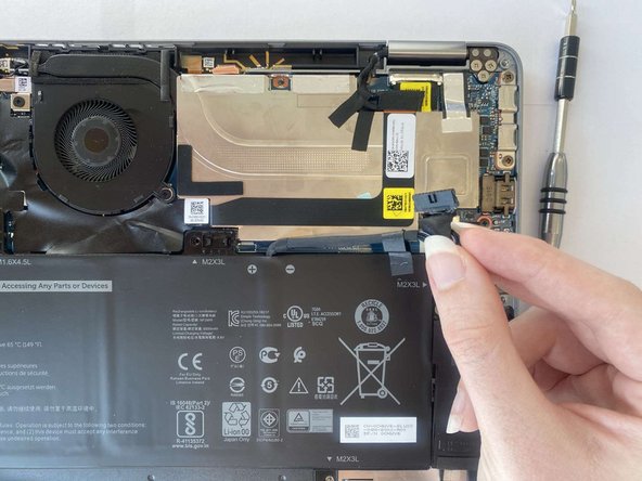

    • Grip the battery cable near the plug and pull it straight out, in the direction of the cable.

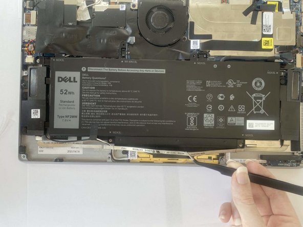

    • Use tweezers to gently move the speaker ribbon cable away from the bottom of the battery.
    • The ribbon cable is thin and fragile; handle it carefully.
    • The ribbon cable only needs to be moved so that the battery can be removed; do not completely remove the ribbon cable.

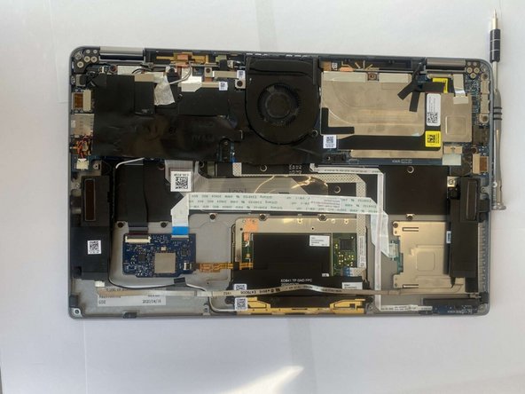

    • Lift the battery out with two hands.

Just one question about the speaker ribbon glued to the battery (Step 7). I can't remove the ribbon from my battery. The glue is very strong. I've pulled firmly, and I'm worried about breaking the cable. Any ideas about how to loosen the glue without damaging the computer, perhaps by applying heat or some sort of solvent?
