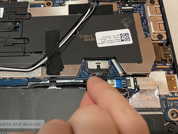

  7. Dell Latitude 7390 (2-in-1) Wi-Fi Card Replacement: crwdns2935265:07crwdnd2935265:01crwdnd2935265:03crwdne2935265:0 Dell Latitude 7390 (2-in-1) Wi-Fi Card Replacement: crwdns2935265:07crwdnd2935265:02crwdnd2935265:03crwdne2935265:0 Dell Latitude 7390 (2-in-1) Wi-Fi Card Replacement: crwdns2935265:07crwdnd2935265:03crwdnd2935265:03crwdne2935265:0
    • Be careful not to break the connector by pulling too hard on the black tab.
    • Pull the black tab on the top of the connector to unplug the battery from the motherboard.

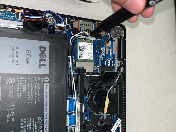

  9. Dell Latitude 7390 (2-in-1) Wi-Fi Card Replacement, Wi-Fi Card: crwdns2935265:09crwdnd2935265:01crwdnd2935265:02crwdne2935265:0 Dell Latitude 7390 (2-in-1) Wi-Fi Card Replacement, Wi-Fi Card: crwdns2935265:09crwdnd2935265:02crwdnd2935265:02crwdne2935265:0
    • Using a Phillips #1 screwdriver, remove the 3 mm screw securing the Wi-Fi card.
  10. Dell Latitude 7390 (2-in-1) Wi-Fi Card Replacement: crwdns2935265:010crwdnd2935265:01crwdnd2935265:01crwdne2935265:0
    • Detach the coaxial connectors from the Wi-Fi card with tweezers.
    • Before removing the wires, it is important to note the location of the corresponding connectors. When it comes to reconnecting the wires they will need to be placed in the correct port in order to function correctly.
  11. Dell Latitude 7390 (2-in-1) Wi-Fi Card Replacement: crwdns2935265:011crwdnd2935265:01crwdnd2935265:01crwdne2935265:0
    • After the wires have been disconnected, pull the chip out of the connector and place the part aside.
