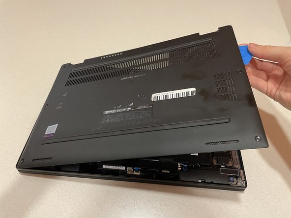

    • Orient your Dell Latitude 7390 laptop so that it is facing towards you as if you're going to open it.
  2. Dell Latitude 7390 (2-in-1) Bottom Panel Replacement: crwdns2935265:02crwdnd2935265:01crwdnd2935265:03crwdne2935265:0 Dell Latitude 7390 (2-in-1) Bottom Panel Replacement: crwdns2935265:02crwdnd2935265:02crwdnd2935265:03crwdne2935265:0 Dell Latitude 7390 (2-in-1) Bottom Panel Replacement: crwdns2935265:02crwdnd2935265:03crwdnd2935265:03crwdne2935265:0
    • Flip your laptop over so that the bottom is facing up.
  3. Dell Latitude 7390 (2-in-1) Bottom Panel Replacement: crwdns2935265:03crwdnd2935265:01crwdnd2935265:01crwdne2935265:0
    • Using your Phillips #1 screwdriver, remove the eight 6 mm screws around the border of the bottom panel.
  4. Dell Latitude 7390 (2-in-1) Bottom Panel Replacement: crwdns2935265:04crwdnd2935265:01crwdnd2935265:02crwdne2935265:0 Dell Latitude 7390 (2-in-1) Bottom Panel Replacement: crwdns2935265:04crwdnd2935265:02crwdnd2935265:02crwdne2935265:0
    • Using an opening tool or picks, work your way around the periphery and pry the back case off.
  5. Dell Latitude 7390 (2-in-1) Bottom Panel Replacement: crwdns2935265:05crwdnd2935265:01crwdnd2935265:01crwdne2935265:0
    • Finally, lift the back panel off to uncover the inside of your Dell Latitude 7390.
