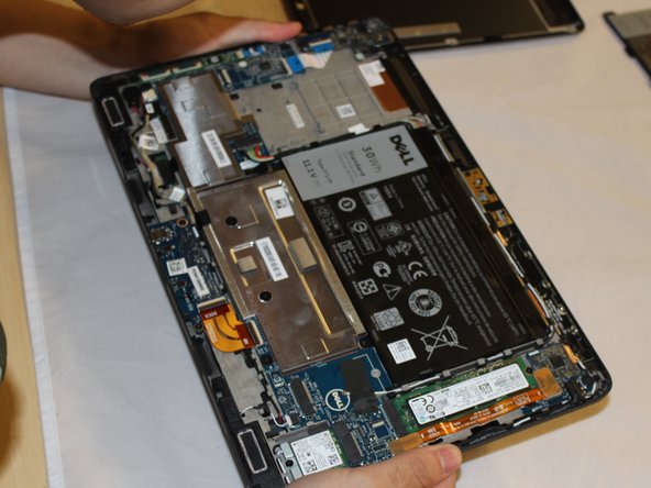

    • Avoid static discharge by grounding yourself using a wrist grounding strap or by touching a bare metal surface like a connector on the back of the laptop. Remove all of the power including the battery and power adapter.
    • Unscrew and remove the battery.

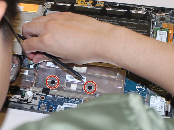

    • Take off the screen battery.
    • Remove the following screw.

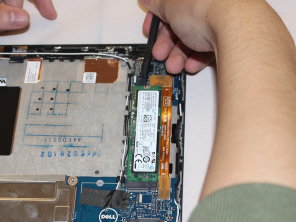

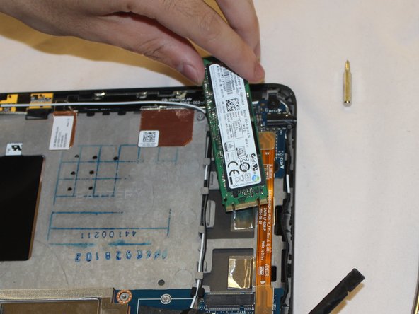

    • Unscrew and remove SSD from motherboard.
    • Disconnect then unscrew and remove audio circuit board.
