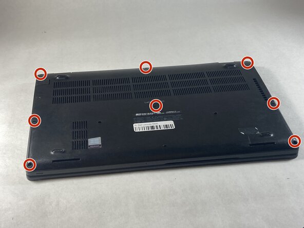

    • Use a Phillips #0 screwdriver to loosen the eight captive screws on the back panel.
