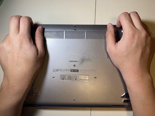

    • Loosen all eight 2.5 mm captive Phillips #1 screws that secure the lower case.
    • As the screws are captive, they will remain in the case after being loosened.
  2. Dell Latitude 5411 Lower Case Replacement: crwdns2935265:02crwdnd2935265:01crwdnd2935265:02crwdne2935265:0 Dell Latitude 5411 Lower Case Replacement: crwdns2935265:02crwdnd2935265:02crwdnd2935265:02crwdne2935265:0
    • Lift the base cover starting from the left hinge.
    • If it is hard to pull off, make sure that all the screws are loose.
