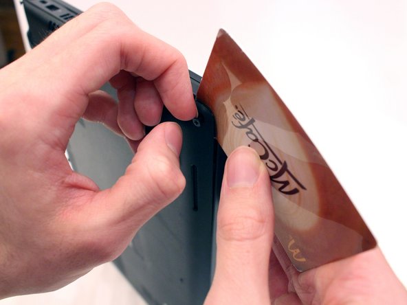

  3. Dell Latitude 5401 RAM Replacement: crwdns2935265:03crwdnd2935265:01crwdnd2935265:03crwdne2935265:0 Dell Latitude 5401 RAM Replacement: crwdns2935265:03crwdnd2935265:02crwdnd2935265:03crwdne2935265:0 Dell Latitude 5401 RAM Replacement: crwdns2935265:03crwdnd2935265:03crwdnd2935265:03crwdne2935265:0
    Plastic Cards
    $2.99

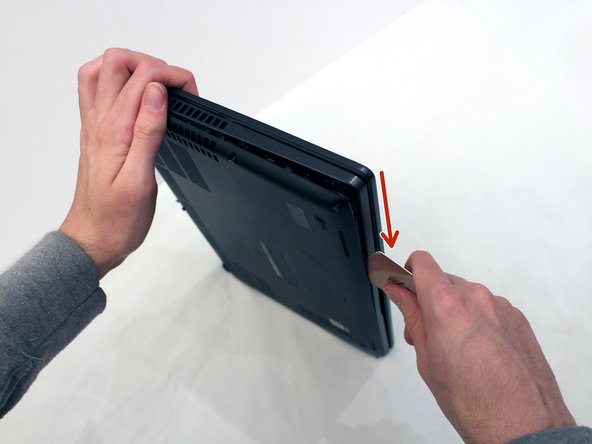

    • Expose the seam that connects the laptop case by pulling on a corner screw while holding the base.
    • Insert a plastic card into the gap.
    • Slide the card around the perimeter of the case to release the clips.
    • Gently pry the laptop apart.
    • This step can be difficult and will take some time and strength!

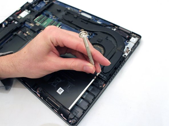

    • Use a small Phillips screwdriver to loosen the two screws securing the battery.
    • These screws are captive and should not be removed.
    • If the battery is swollen, be very careful and follow these safety suggestions.

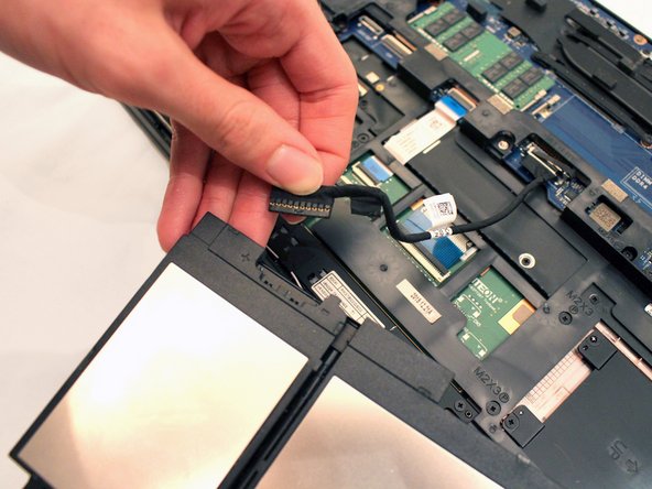

    • Carefully remove the battery from the case.
    • Flip the battery over.
    • Grip the battery cable tab and pull the cable from the battery to separate it from the device.
    • Do not bend or twist the battery during the removal.

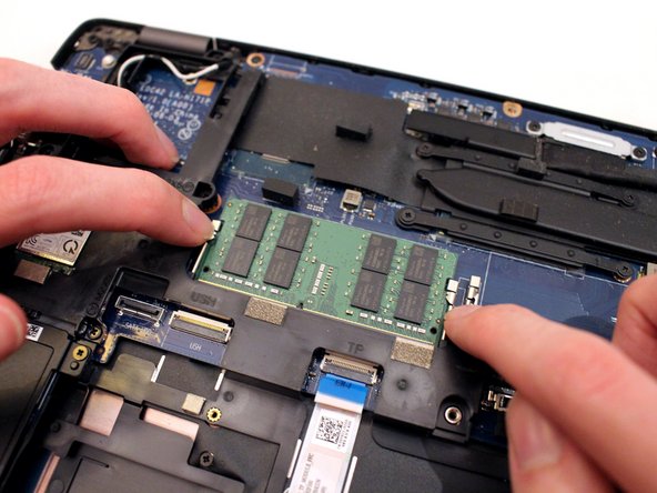

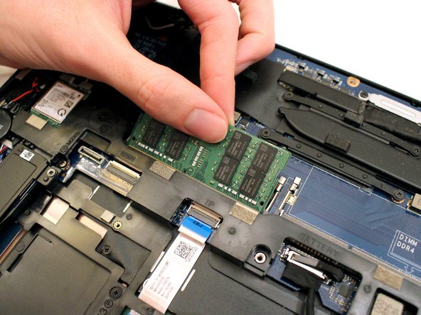

    • Gently pull the metal arms on both sides of the RAM stick away slightly to release it.
    • The RAM will pop up by a few millimeters.
    • Remove it at an angle and not straight up so you don't damage the socket.
    • Check online to see how to properly dispose of e-waste in your region.

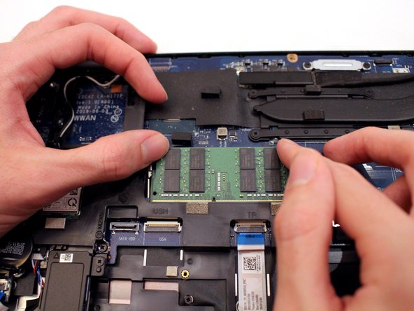

    • Insert the new RAM stick into the slot at the same angle that you used to remove the original.
    • Be sure to insert the grooved edge into the socket so the pins line up correctly to avoid damaging the socket and the RAM.
    • Push down on the RAM until you hear a "click".
    • The two metal arms should now hold the RAM in place.
