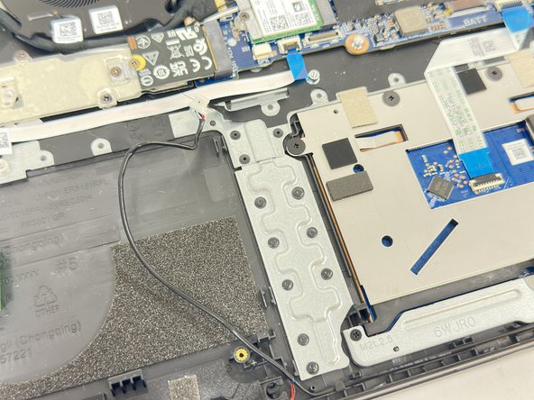

  6. Dell Latitude 3520 Speaker Replacement, Speaker: crwdns2935265:06crwdnd2935265:01crwdnd2935265:02crwdne2935265:0 Dell Latitude 3520 Speaker Replacement, Speaker: crwdns2935265:06crwdnd2935265:02crwdnd2935265:02crwdne2935265:0
    • Disconnect the speaker cable from the connector on the system board.
  7. Dell Latitude 3520 Speaker Replacement: crwdns2935265:07crwdnd2935265:01crwdnd2935265:01crwdne2935265:0
    • Unroute the speaker cable from the routing guides assembly.
  8. Dell Latitude 3520 Speaker Replacement: crwdns2935265:08crwdnd2935265:01crwdnd2935265:01crwdne2935265:0
    • Peel the adhesive tapes, lift them, and remove the speakers.
