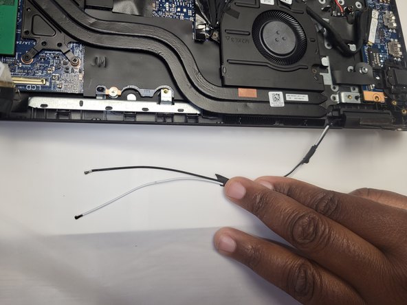

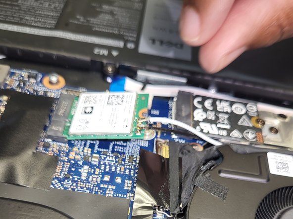

  3. Dell Latitude 3520 Screen Replacement, Screen Removal: crwdns2935265:03crwdnd2935265:01crwdnd2935265:03crwdne2935265:0 Dell Latitude 3520 Screen Replacement, Screen Removal: crwdns2935265:03crwdnd2935265:02crwdnd2935265:03crwdne2935265:0 Dell Latitude 3520 Screen Replacement, Screen Removal: crwdns2935265:03crwdnd2935265:03crwdnd2935265:03crwdne2935265:0
    • Remove the 2mm Phillip #0 screw that secures the WLAN card bracket to the WLAN card on the system board.
    • Lift and remove the WLAN card bracket from the WLAN card that secures the two antenna cables.
    • Disconnect the antenna cables from the connectors on the WLAN card.
    • Disconnect and remove the WLAN card from the WLAN card slot.
