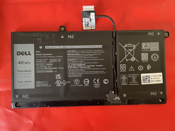

  3. Dell Latitude 3510 Battery Replacement, Battery removal: crwdns2935265:03crwdnd2935265:01crwdnd2935265:03crwdne2935265:0 Dell Latitude 3510 Battery Replacement, Battery removal: crwdns2935265:03crwdnd2935265:02crwdnd2935265:03crwdne2935265:0 Dell Latitude 3510 Battery Replacement, Battery removal: crwdns2935265:03crwdnd2935265:03crwdnd2935265:03crwdne2935265:0
    • Locate the four screws holding the battery in place. They are marked with M2 and arrows. Unscrew them all.

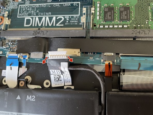

    • The connection between the battery and the mainboard is easily disconnected by pulling the plug while wiggling a little left and right with your fingernails or a spudger.
    • Do not pull on the cables but the plastic connector to avoid damages to the cord.
    • Lift out the battery and replace it with the new one. You're finished!
