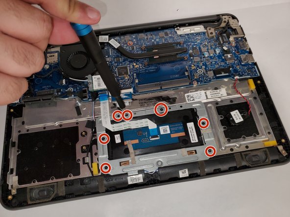

  4. Dell Latitude 3380 Touchpad Replacement, Touchpad: crwdns2935265:04crwdnd2935265:01crwdnd2935265:03crwdne2935265:0 Dell Latitude 3380 Touchpad Replacement, Touchpad: crwdns2935265:04crwdnd2935265:02crwdnd2935265:03crwdne2935265:0 Dell Latitude 3380 Touchpad Replacement, Touchpad: crwdns2935265:04crwdnd2935265:03crwdnd2935265:03crwdne2935265:0
    • Unplug the touchpad cable using a spudger.
    • Remove the seven screws with a Phillips #0 screwdriver.
    • Remove the metal plate and place it to the side.

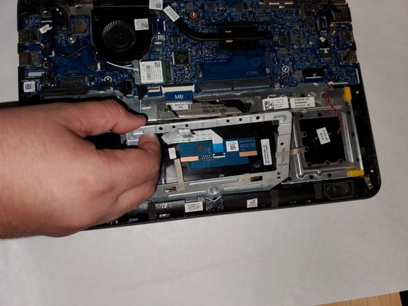

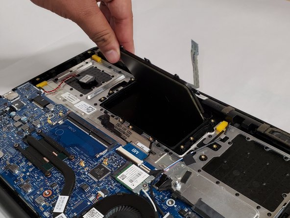

  5. Dell Latitude 3380 Touchpad Replacement: crwdns2935265:05crwdnd2935265:01crwdnd2935265:02crwdne2935265:0 Dell Latitude 3380 Touchpad Replacement: crwdns2935265:05crwdnd2935265:02crwdnd2935265:02crwdne2935265:0
    • Remove the three screws with the Phillips #0 screwdriver.
    • Remove the touchpad from the laptop.
