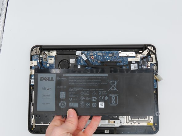

  3. Dell Latitude 3380 Motherboard Replacement, Motherboard: crwdns2935265:03crwdnd2935265:01crwdnd2935265:03crwdne2935265:0 Dell Latitude 3380 Motherboard Replacement, Motherboard: crwdns2935265:03crwdnd2935265:02crwdnd2935265:03crwdne2935265:0 Dell Latitude 3380 Motherboard Replacement, Motherboard: crwdns2935265:03crwdnd2935265:03crwdnd2935265:03crwdne2935265:0

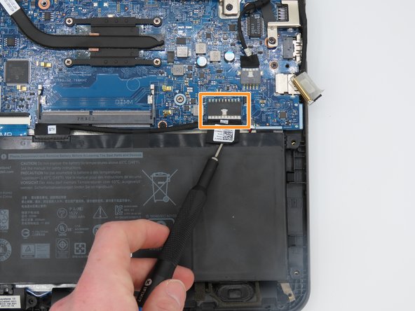

    • Remove the four 3 mm screws holding the battery in place using a Phillips #0 screwdriver.
    • Disconnect the battery cable by gently pulling it out.
    • Remove the battery.

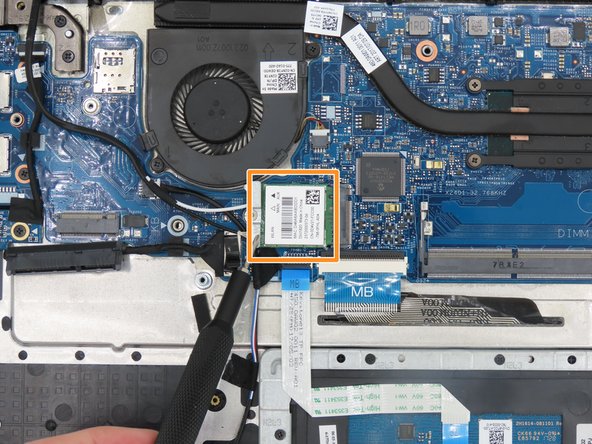

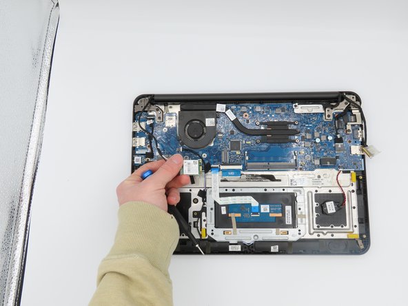

  4. Dell Latitude 3380 Motherboard Replacement: crwdns2935265:04crwdnd2935265:01crwdnd2935265:03crwdne2935265:0 Dell Latitude 3380 Motherboard Replacement: crwdns2935265:04crwdnd2935265:02crwdnd2935265:03crwdne2935265:0 Dell Latitude 3380 Motherboard Replacement: crwdns2935265:04crwdnd2935265:03crwdnd2935265:03crwdne2935265:0
    • Remove the 3 mm screw from the WLAN card using a Phillips #0 screwdriver.
    • Disconnect and remove the WLAN card.

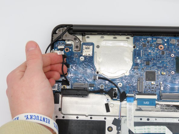

  5. Dell Latitude 3380 Motherboard Replacement: crwdns2935265:05crwdnd2935265:01crwdnd2935265:03crwdne2935265:0 Dell Latitude 3380 Motherboard Replacement: crwdns2935265:05crwdnd2935265:02crwdnd2935265:03crwdne2935265:0 Dell Latitude 3380 Motherboard Replacement: crwdns2935265:05crwdnd2935265:03crwdnd2935265:03crwdne2935265:0
    • Disconnect the audio cable.
    • Remove the entire audio card piece.

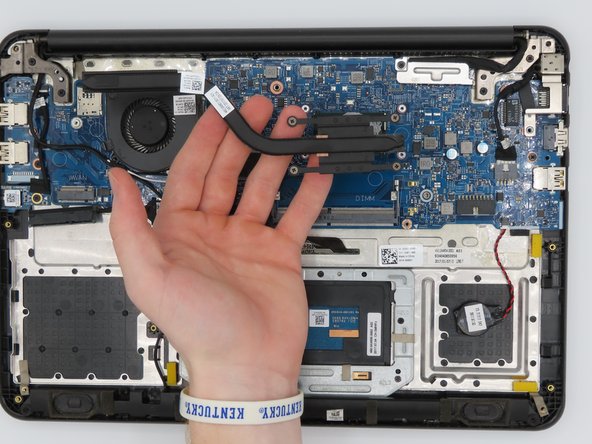

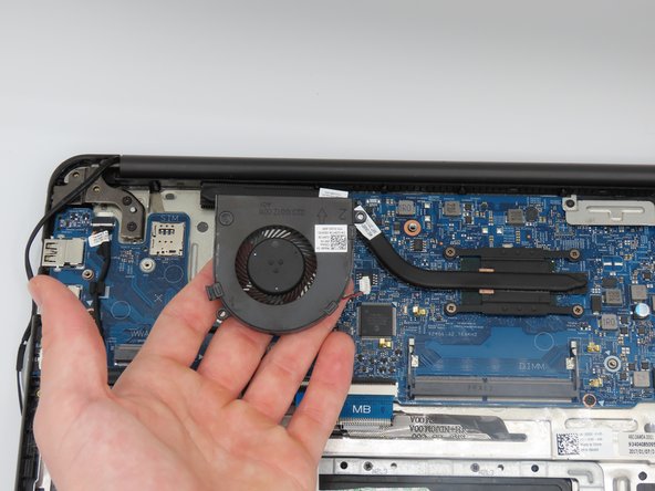

  6. Dell Latitude 3380 Motherboard Replacement: crwdns2935265:06crwdnd2935265:01crwdnd2935265:03crwdne2935265:0 Dell Latitude 3380 Motherboard Replacement: crwdns2935265:06crwdnd2935265:02crwdnd2935265:03crwdne2935265:0 Dell Latitude 3380 Motherboard Replacement: crwdns2935265:06crwdnd2935265:03crwdnd2935265:03crwdne2935265:0
    • Remove the two 5 mm screws from the fan using a Phillips #0 screwdriver.
    • Loosen the four captive screws on the heatsink using a Phillips #0 screwdriver.
    • Remove the heatsink from the motherboard.

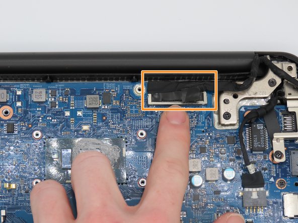

  7. Dell Latitude 3380 Motherboard Replacement: crwdns2935265:07crwdnd2935265:01crwdnd2935265:02crwdne2935265:0 Dell Latitude 3380 Motherboard Replacement: crwdns2935265:07crwdnd2935265:02crwdnd2935265:02crwdne2935265:0
    • Using tweezers, loosen the power connector from the fan to the motherboard, fully disconnecting the fan.

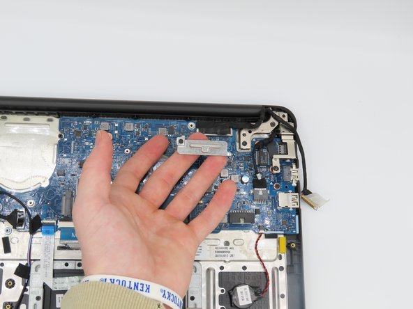

  8. Dell Latitude 3380 Motherboard Replacement: crwdns2935265:08crwdnd2935265:01crwdnd2935265:03crwdne2935265:0 Dell Latitude 3380 Motherboard Replacement: crwdns2935265:08crwdnd2935265:02crwdnd2935265:03crwdne2935265:0 Dell Latitude 3380 Motherboard Replacement: crwdns2935265:08crwdnd2935265:03crwdnd2935265:03crwdne2935265:0

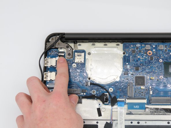

    • Using a Phillips #0 screwdriver, unscrew and remove this metal plate.
    • Gently disconnect the cable under the metal plate.

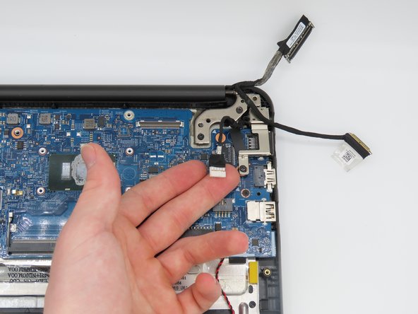

  9. Dell Latitude 3380 Motherboard Replacement: crwdns2935265:09crwdnd2935265:01crwdnd2935265:02crwdne2935265:0 Dell Latitude 3380 Motherboard Replacement: crwdns2935265:09crwdnd2935265:02crwdnd2935265:02crwdne2935265:0

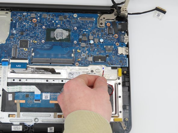

    • Disconnect the battery power cable.
  10. Dell Latitude 3380 Motherboard Replacement: crwdns2935265:010crwdnd2935265:01crwdnd2935265:02crwdne2935265:0 Dell Latitude 3380 Motherboard Replacement: crwdns2935265:010crwdnd2935265:02crwdnd2935265:02crwdne2935265:0
    • Disconnect the power cable that connects to the charging port.
  11. Dell Latitude 3380 Motherboard Replacement: crwdns2935265:011crwdnd2935265:01crwdnd2935265:02crwdne2935265:0 Dell Latitude 3380 Motherboard Replacement: crwdns2935265:011crwdnd2935265:02crwdnd2935265:02crwdne2935265:0
    • Disconnect the touchpad cable.
  12. Dell Latitude 3380 Motherboard Replacement: crwdns2935265:012crwdnd2935265:01crwdnd2935265:02crwdne2935265:0 Dell Latitude 3380 Motherboard Replacement: crwdns2935265:012crwdnd2935265:02crwdnd2935265:02crwdne2935265:0

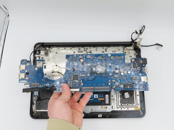

    • Remove the five screws from the motherboard using a Phillips #0 screwdriver.
    • Remove the motherboard.
