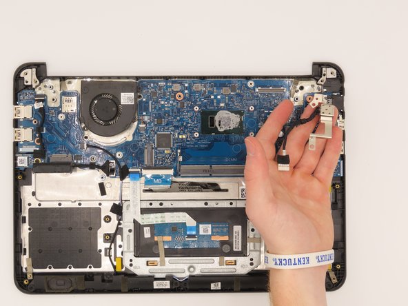

  4. Dell Latitude 3380 Front Camera Replacement: crwdns2935265:04crwdnd2935265:01crwdnd2935265:01crwdne2935265:0
    • Detach the power cable connecting the display to the motherboard.

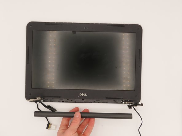

    • Using your fingers (or an opening tool if necessary), gently pry off the bottom cover on the display.

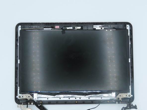

  7. Dell Latitude 3380 Front Camera Replacement: crwdns2935265:07crwdnd2935265:01crwdnd2935265:02crwdne2935265:0 Dell Latitude 3380 Front Camera Replacement: crwdns2935265:07crwdnd2935265:02crwdnd2935265:02crwdne2935265:0
    • Remove the screw caps, then the screws using a Phillips #0 screwdriver.
    • Remove the plastic outer covering using an opening tool.

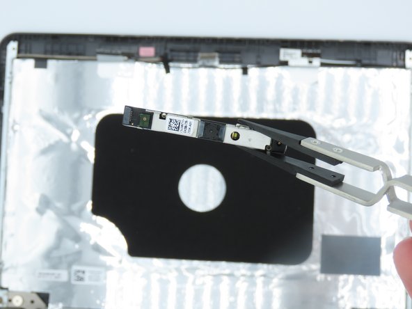

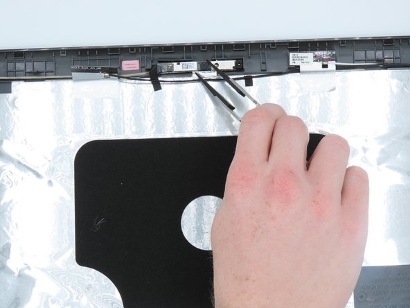

  8. Dell Latitude 3380 Front Camera Replacement: crwdns2935265:08crwdnd2935265:01crwdnd2935265:03crwdne2935265:0 Dell Latitude 3380 Front Camera Replacement: crwdns2935265:08crwdnd2935265:02crwdnd2935265:03crwdne2935265:0 Dell Latitude 3380 Front Camera Replacement: crwdns2935265:08crwdnd2935265:03crwdnd2935265:03crwdne2935265:0
    • Remove the front camera by gently pulling it out with a pair of tweezers.
