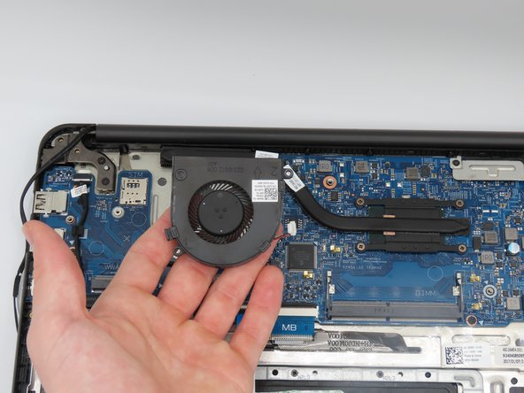

  3. Dell Latitude 3380 Fan Replacement, Fan: crwdns2935265:03crwdnd2935265:01crwdnd2935265:01crwdne2935265:0
    • Remove the two 5 mm screws from the fan using a Phillips #0 screwdriver.
  4. Dell Latitude 3380 Fan Replacement: crwdns2935265:04crwdnd2935265:01crwdnd2935265:01crwdne2935265:0
    • Loosen the four captive screws on the heatsink using a Phillips #0 screwdriver.
  5. Dell Latitude 3380 Fan Replacement: crwdns2935265:05crwdnd2935265:01crwdnd2935265:01crwdne2935265:0
    • Remove the heatsink from the motherboard.
  6. Dell Latitude 3380 Fan Replacement: crwdns2935265:06crwdnd2935265:01crwdnd2935265:02crwdne2935265:0 Dell Latitude 3380 Fan Replacement: crwdns2935265:06crwdnd2935265:02crwdnd2935265:02crwdne2935265:0
    • Using tweezers, loosen the power connector from the fan to the motherboard, fully disconnecting the fan.
