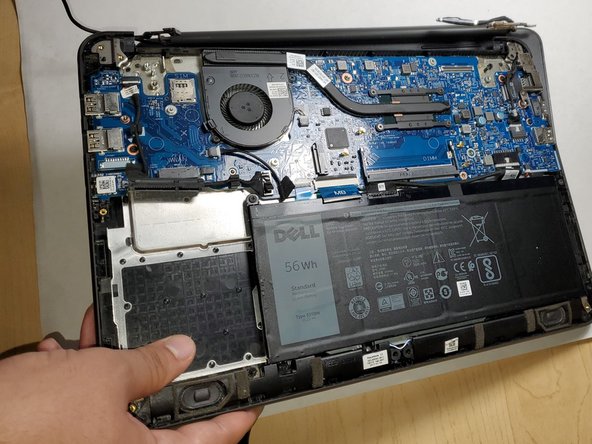

    • Turn the laptop over so that the back is facing up.
    • Remove the nine 3 mm screws with a Phillips #0 screwdriver.
  2. Dell Latitude 3380 Display Assembly Replacement: crwdns2935265:02crwdnd2935265:01crwdnd2935265:02crwdne2935265:0 Dell Latitude 3380 Display Assembly Replacement: crwdns2935265:02crwdnd2935265:02crwdnd2935265:02crwdne2935265:0
    • Use an opening tool to pry the back cover away from the laptop.

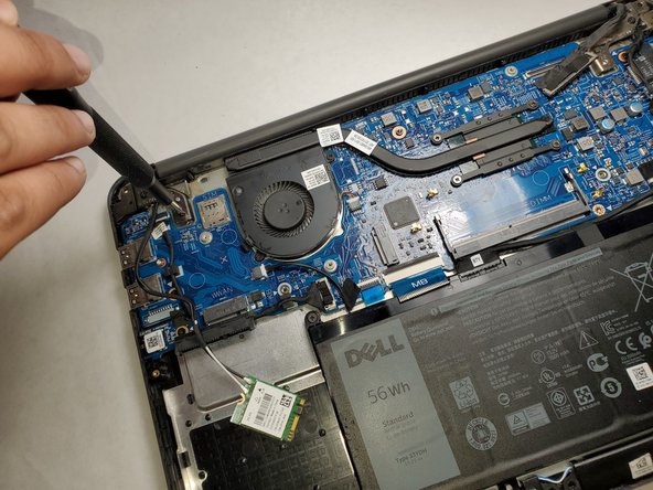

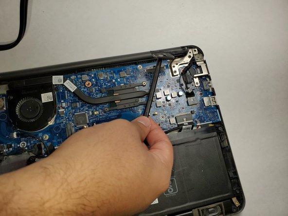

  3. Dell Latitude 3380 Display Assembly Replacement, Display Assembly: crwdns2935265:03crwdnd2935265:01crwdnd2935265:03crwdne2935265:0 Dell Latitude 3380 Display Assembly Replacement, Display Assembly: crwdns2935265:03crwdnd2935265:02crwdnd2935265:03crwdne2935265:0 Dell Latitude 3380 Display Assembly Replacement, Display Assembly: crwdns2935265:03crwdnd2935265:03crwdnd2935265:03crwdne2935265:0
    • Remove the single 3 mm screw from the metal bracket using a Phillips #0 screwdriver.
    • Remove the metal bracket.
    • Use a spudger to gently detach the connector from the motherboard.

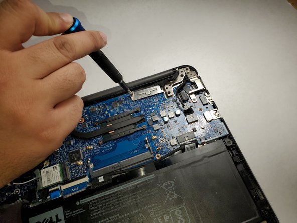

  4. Dell Latitude 3380 Display Assembly Replacement: crwdns2935265:04crwdnd2935265:01crwdnd2935265:03crwdne2935265:0 Dell Latitude 3380 Display Assembly Replacement: crwdns2935265:04crwdnd2935265:02crwdnd2935265:03crwdne2935265:0 Dell Latitude 3380 Display Assembly Replacement: crwdns2935265:04crwdnd2935265:03crwdnd2935265:03crwdne2935265:0
    • Remove the two 3 mm screws (four total) from both sides of the laptop using a Phillips #0 screwdriver.
    • Lift up the bottom part of the laptop to separate the display assembly from the rest of the laptop.
