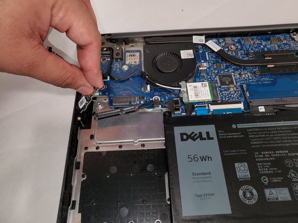

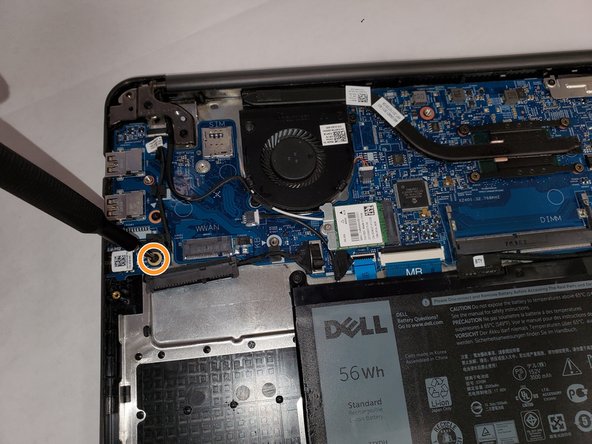

  3. Dell Latitude 3380 Audio Card Replacement, Audio Card: crwdns2935265:03crwdnd2935265:01crwdnd2935265:03crwdne2935265:0 Dell Latitude 3380 Audio Card Replacement, Audio Card: crwdns2935265:03crwdnd2935265:02crwdnd2935265:03crwdne2935265:0 Dell Latitude 3380 Audio Card Replacement, Audio Card: crwdns2935265:03crwdnd2935265:03crwdnd2935265:03crwdne2935265:0
    • Gently disconnect the audio jack from the motherboard.
    • Remove the single 3 mm screw using a Phillips #0 screwdriver.
    • Lift up on the audio card and remove it from the laptop.
