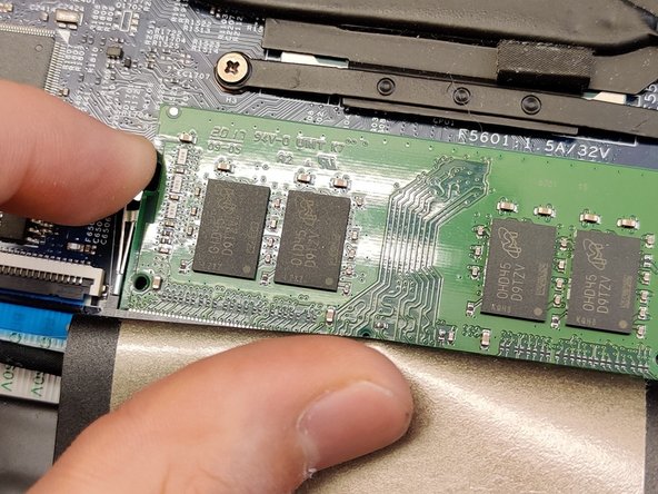

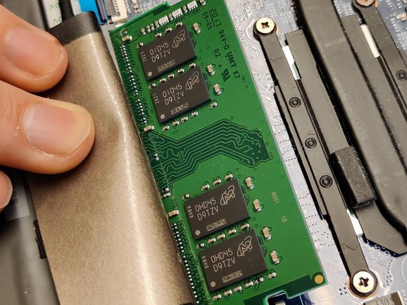

  2. Dell Latitude 3310 Teardown, RAM: crwdns2935265:04crwdnd2935265:01crwdnd2935265:03crwdne2935265:0 Dell Latitude 3310 Teardown, RAM: crwdns2935265:04crwdnd2935265:02crwdnd2935265:03crwdne2935265:0 Dell Latitude 3310 Teardown, RAM: crwdns2935265:04crwdnd2935265:03crwdnd2935265:03crwdne2935265:0
    • Remove the top of the sheet covering the RAM
    • Instructions for removing the RAM are accessible on the sheet that covers the RAM
    • Press the metal rails aside with your fingertips.
    • Take the RAM out and place on a flat surface.

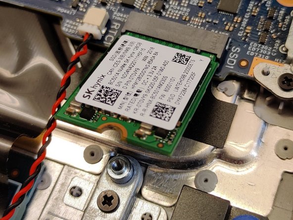

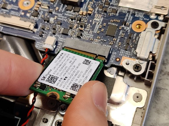

  3. Dell Latitude 3310 Teardown, SSD: crwdns2935265:05crwdnd2935265:01crwdnd2935265:03crwdne2935265:0 Dell Latitude 3310 Teardown, SSD: crwdns2935265:05crwdnd2935265:02crwdnd2935265:03crwdne2935265:0 Dell Latitude 3310 Teardown, SSD: crwdns2935265:05crwdnd2935265:03crwdnd2935265:03crwdne2935265:0
    • Remove the single M2x3 screw
    • Wiggle the M.2 disk away from the motherboard.
    • The standoff consists of a single M2 screw that can be removed.

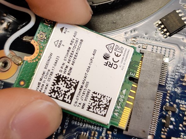

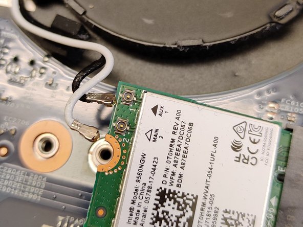

  4. Dell Latitude 3310 Teardown, WLAN-card: crwdns2935265:06crwdnd2935265:01crwdnd2935265:03crwdne2935265:0 Dell Latitude 3310 Teardown, WLAN-card: crwdns2935265:06crwdnd2935265:02crwdnd2935265:03crwdne2935265:0 Dell Latitude 3310 Teardown, WLAN-card: crwdns2935265:06crwdnd2935265:03crwdnd2935265:03crwdne2935265:0
    • Move the mounting plate aside
    • Disconnect the antennas
    • Wiggle the card away from the motherboard
    • Rearrange the antenna cables for easier removal of the motherboard later

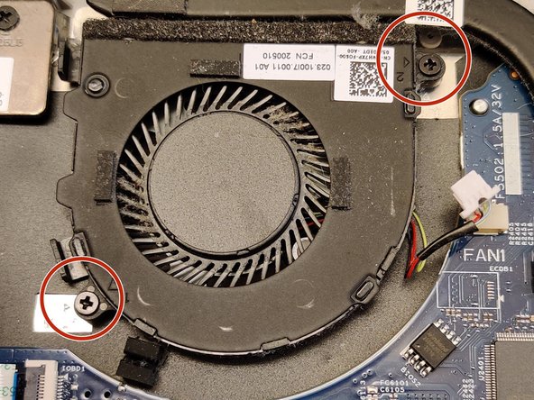

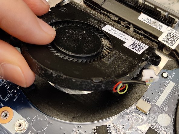

  5. Dell Latitude 3310 Teardown, Fan: crwdns2935265:07crwdnd2935265:01crwdnd2935265:03crwdne2935265:0 Dell Latitude 3310 Teardown, Fan: crwdns2935265:07crwdnd2935265:02crwdnd2935265:03crwdne2935265:0 Dell Latitude 3310 Teardown, Fan: crwdns2935265:07crwdnd2935265:03crwdnd2935265:03crwdne2935265:0
    • Disconnect the fan from the header
    • Remove 2 M2x3 screws
    • Move the fan aside
    • Take the opportunity to remove dust from the fan

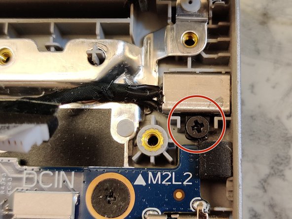

    • Then disconnect the DC-cable.
    • You can remove the DC-connector by removing this screw. No markings, but I'd say this one is M2x2.

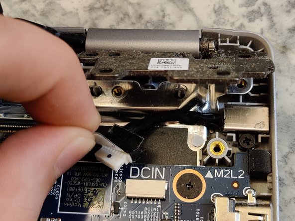

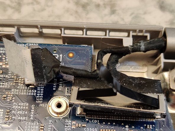

  8. Dell Latitude 3310 Teardown, Motherboard Part 3: crwdns2935265:010crwdnd2935265:01crwdnd2935265:03crwdne2935265:0 Dell Latitude 3310 Teardown, Motherboard Part 3: crwdns2935265:010crwdnd2935265:02crwdnd2935265:03crwdne2935265:0 Dell Latitude 3310 Teardown, Motherboard Part 3: crwdns2935265:010crwdnd2935265:03crwdnd2935265:03crwdne2935265:0

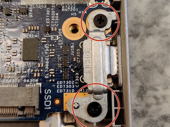

    • Diconnect makred cables. Make sure to lift up locking tabs with a plastic tool. CMOS and speaker cable are disconnected by pulling on the white connector on the cable.

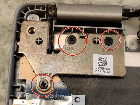

    • Remove 3 M2.5x5 screws and lift the metal hinge.
    • Remove 2 M2x5 screws that hold metal bracket over USB-C connector.

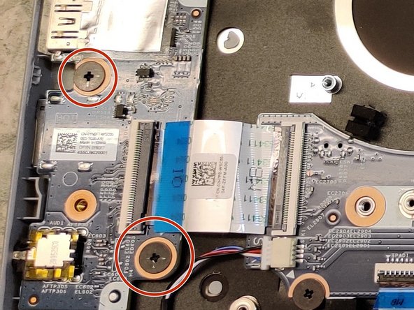

  9. Dell Latitude 3310 Teardown, Motherboard Part 4: crwdns2935265:011crwdnd2935265:01crwdnd2935265:03crwdne2935265:0 Dell Latitude 3310 Teardown, Motherboard Part 4: crwdns2935265:011crwdnd2935265:02crwdnd2935265:03crwdne2935265:0 Dell Latitude 3310 Teardown, Motherboard Part 4: crwdns2935265:011crwdnd2935265:03crwdnd2935265:03crwdne2935265:0
    • Remove 2 M2x5 motherboard screws
    • Remove 2 M2x2 I/O-board screws
    • Lift and move aside motherboard and I/O-board
    • Place on anti-stat mat or similar surface

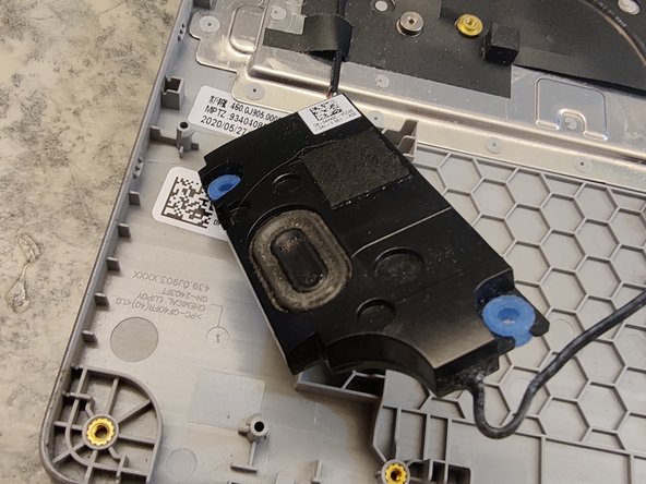

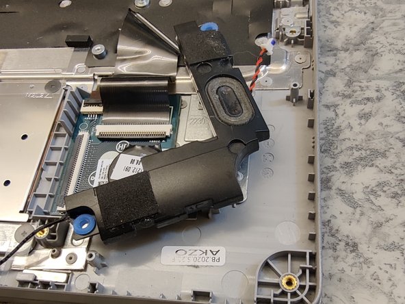

  10. Dell Latitude 3310 Teardown, Speakers: crwdns2935265:012crwdnd2935265:01crwdnd2935265:03crwdne2935265:0 Dell Latitude 3310 Teardown, Speakers: crwdns2935265:012crwdnd2935265:02crwdnd2935265:03crwdne2935265:0 Dell Latitude 3310 Teardown, Speakers: crwdns2935265:012crwdnd2935265:03crwdnd2935265:03crwdne2935265:0
    • You can simply lift away the speakers and carefully wriggle out the cables
    • I disconnected and removed the MB (motherboard) to KB (keyboard) cable and MB to TP(trackpad) cable.
    • CMOS battery is stuck to frame with glue. The last cable goes to the keyboard that is hard mounted to the frame as well.

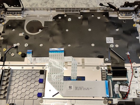

  11. Dell Latitude 3310 Teardown, Trackpad: crwdns2935265:013crwdnd2935265:01crwdnd2935265:01crwdne2935265:0
    • Remove 6 M2x2 screws
    • Move the trackpad aside
    • The keyboard is hard mounted to the armrest.
    • You should be able to lift the armrest up like you open up the laptop and remove it from the screen.
    • The screen can be open by prying all around the edge and then remove 4 M2x2 or smaller screws to replace the LCD screen.
