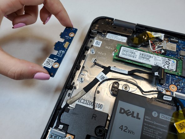

  7. Dell Latitude 3190 Power Switch Board Replacement, Power Switch Board: crwdns2935265:07crwdnd2935265:01crwdnd2935265:02crwdne2935265:0 Dell Latitude 3190 Power Switch Board Replacement, Power Switch Board: crwdns2935265:07crwdnd2935265:02crwdnd2935265:02crwdne2935265:0
    • Disconnect the power switch cable from the motherboard.
  8. Dell Latitude 3190 Power Switch Board Replacement: crwdns2935265:08crwdnd2935265:01crwdnd2935265:03crwdne2935265:0 Dell Latitude 3190 Power Switch Board Replacement: crwdns2935265:08crwdnd2935265:02crwdnd2935265:03crwdne2935265:0 Dell Latitude 3190 Power Switch Board Replacement: crwdns2935265:08crwdnd2935265:03crwdnd2935265:03crwdne2935265:0
    • Remove the two 3 mm screws that secure the power switch board on the computer.
  9. Dell Latitude 3190 Power Switch Board Replacement: crwdns2935265:09crwdnd2935265:01crwdnd2935265:02crwdne2935265:0 Dell Latitude 3190 Power Switch Board Replacement: crwdns2935265:09crwdnd2935265:02crwdnd2935265:02crwdne2935265:0
    • Lift the power switchboard away from the computer.
