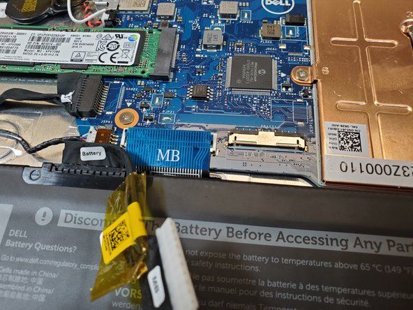

  3. Dell Latitude 3190 Keyboard Replacement, Battery: crwdns2935265:03crwdnd2935265:01crwdnd2935265:01crwdne2935265:0
    • Locate the battery.
  4. Dell Latitude 3190 Keyboard Replacement: crwdns2935265:04crwdnd2935265:01crwdnd2935265:03crwdne2935265:0 Dell Latitude 3190 Keyboard Replacement: crwdns2935265:04crwdnd2935265:02crwdnd2935265:03crwdne2935265:0 Dell Latitude 3190 Keyboard Replacement: crwdns2935265:04crwdnd2935265:03crwdnd2935265:03crwdne2935265:0
    • Disconnect the battery cable located on the top of the battery.
    • Use the spudger and disconnect the battery cable.
    • Pull the cable out of the way.

  7. Dell Latitude 3190 Keyboard Replacement, Keyboard: crwdns2935265:07crwdnd2935265:01crwdnd2935265:02crwdne2935265:0 Dell Latitude 3190 Keyboard Replacement, Keyboard: crwdns2935265:07crwdnd2935265:02crwdnd2935265:02crwdne2935265:0
    • Use the spudger to release the small black tab locking down the connector by lightly pushing up on it.
    • Disconnect the keyboard cable from the connector on the system board.

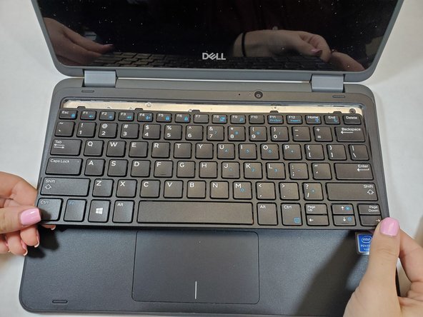

  8. Dell Latitude 3190 Keyboard Replacement: crwdns2935265:08crwdnd2935265:01crwdnd2935265:02crwdne2935265:0 Dell Latitude 3190 Keyboard Replacement: crwdns2935265:08crwdnd2935265:02crwdnd2935265:02crwdne2935265:0
    • Hold down the laptop securely while pushing into the two release holes using a spudger.
    • You may need to push harder than you think, you will feel it release.

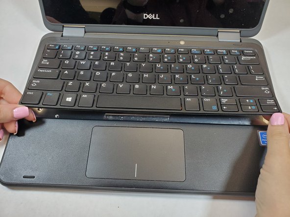

  9. Dell Latitude 3190 Keyboard Replacement: crwdns2935265:09crwdnd2935265:01crwdnd2935265:03crwdne2935265:0 Dell Latitude 3190 Keyboard Replacement: crwdns2935265:09crwdnd2935265:02crwdnd2935265:03crwdne2935265:0 Dell Latitude 3190 Keyboard Replacement: crwdns2935265:09crwdnd2935265:03crwdnd2935265:03crwdne2935265:0
    • Turn the laptop over, so the keyboard is facing up
    • Pry the bottom of the keyboard using a spudger to the release the keyboard.
    • Slide the keyboard outwards, away from the computer, and lift the keyboard away from the computer.
