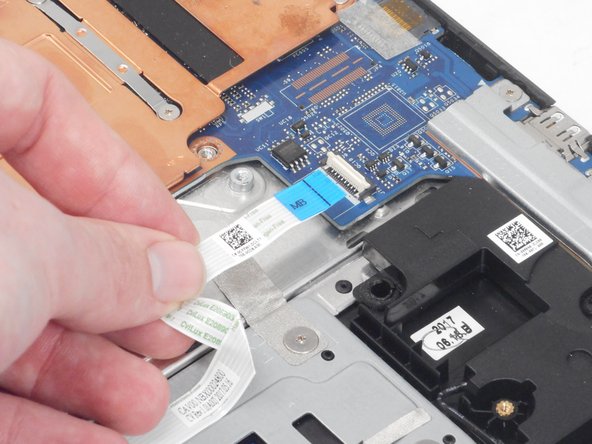

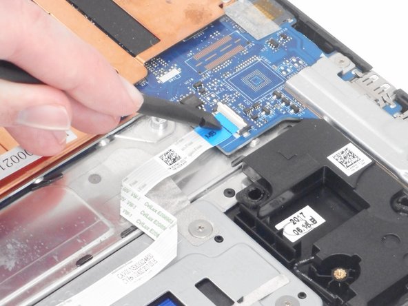

  7. Dell Latitude 3189 Trackpad Replacement, Trackpad: crwdns2935265:07crwdnd2935265:01crwdnd2935265:03crwdne2935265:0 Dell Latitude 3189 Trackpad Replacement, Trackpad: crwdns2935265:07crwdnd2935265:02crwdnd2935265:03crwdne2935265:0 Dell Latitude 3189 Trackpad Replacement, Trackpad: crwdns2935265:07crwdnd2935265:03crwdnd2935265:03crwdne2935265:0
    • Flip up the white ZIF lock bar on the trackpad motherboard socket.
    • Make sure to only lift the flap and not the connector socket because the socket easily breaks off.
    • Gently pull the ribbon cable directly out of its motherboard socket.

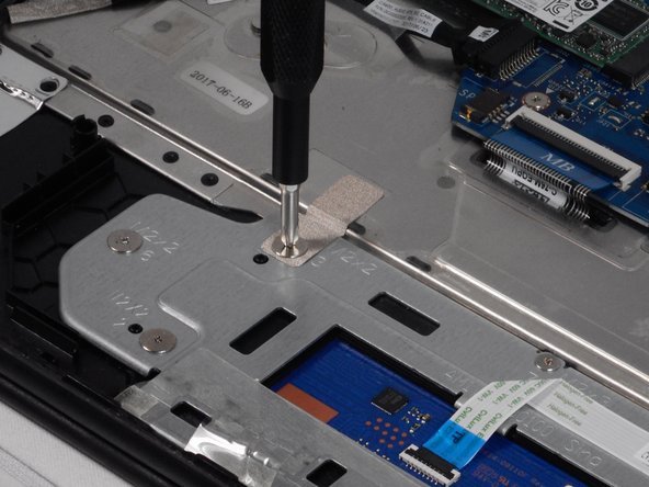

  8. Dell Latitude 3189 Trackpad Replacement: crwdns2935265:08crwdnd2935265:01crwdnd2935265:02crwdne2935265:0 Dell Latitude 3189 Trackpad Replacement: crwdns2935265:08crwdnd2935265:02crwdnd2935265:02crwdne2935265:0
    • Use a Phillips #1 screwdriver to remove the following screws:
    • Six 2.4 mm screws
    • The single 3.6 mm screw
  9. Dell Latitude 3189 Trackpad Replacement: crwdns2935265:09crwdnd2935265:01crwdnd2935265:01crwdne2935265:0
    • Grip the the trackpad and lift it directly out of the chassis.
