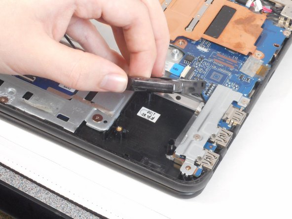

  7. Dell Latitude 3189 Speakers Replacement, Speakers: crwdns2935265:07crwdnd2935265:01crwdnd2935265:01crwdne2935265:0
    • Use the flat end of a spudger to push the white plastic speaker connector out of its motherboard port.
  8. Dell Latitude 3189 Speakers Replacement: crwdns2935265:08crwdnd2935265:01crwdnd2935265:02crwdne2935265:0 Dell Latitude 3189 Speakers Replacement: crwdns2935265:08crwdnd2935265:02crwdnd2935265:02crwdne2935265:0
    • Lift out the right speaker.
    • Lift out the left speaker.
    • Before removing the speakers make note of how the wire between the right and left speakers are routed within the chassis.
