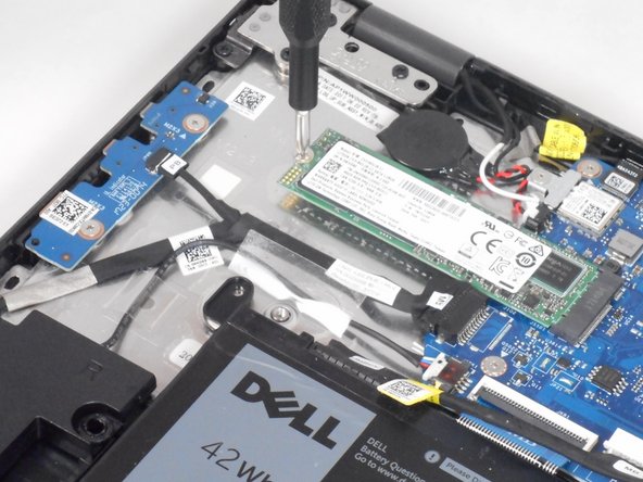

  5. Dell Latitude 3189 SSD Replacement, SSD: crwdns2935265:05crwdnd2935265:01crwdnd2935265:02crwdne2935265:0 Dell Latitude 3189 SSD Replacement, SSD: crwdns2935265:05crwdnd2935265:02crwdnd2935265:02crwdne2935265:0
    • Use a Phillips screwdriver to remove the single 3.2 mm screw that secures the SSD.
    • The SSD will pop up a few millimeters; this is normal.
  6. Dell Latitude 3189 SSD Replacement: crwdns2935265:06crwdnd2935265:01crwdnd2935265:01crwdne2935265:0
    • Gently pull the SSD out of its socket, maintaining the same angle that it flipped up to.
    • Do not pull directly up on the SSD after the screw is removed as you could damage the SSD and/or the connector.
