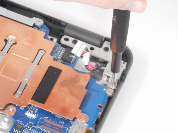

  6. Dell Latitude 3189 Power Jack Replacement: crwdns2935265:06crwdnd2935265:01crwdnd2935265:02crwdne2935265:0 Dell Latitude 3189 Power Jack Replacement: crwdns2935265:06crwdnd2935265:02crwdnd2935265:02crwdne2935265:0
    • Use a Phillips #0 screwdriver to remove the two 3.3 mm screws that secure the power jack to the chassis.
  7. Dell Latitude 3189 Power Jack Replacement: crwdns2935265:07crwdnd2935265:01crwdnd2935265:01crwdne2935265:0
    • Slide and lift the power connector port away from the computer.
