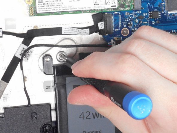

    • Before beginning, power off and unplug the device.
    • Use a Phillips screwdriver to loosen the seven captive screws that secure the lower case.
  2. Dell Latitude 3189 Keyboard Replacement: crwdns2935265:02crwdnd2935265:01crwdnd2935265:03crwdne2935265:0 Dell Latitude 3189 Keyboard Replacement: crwdns2935265:02crwdnd2935265:02crwdnd2935265:03crwdne2935265:0 Dell Latitude 3189 Keyboard Replacement: crwdns2935265:02crwdnd2935265:03crwdnd2935265:03crwdne2935265:0
    • Insert a nylon spudger between the lower case and chassis at the two hinge spaces on the back side of the laptop and pry up the lower case.
    • Do not use metal items to pry the base cover off, like a screwdriver, as it could slip and damage internal components.
    • Avoid prying at the ports.
  3. Dell Latitude 3189 Keyboard Replacement: crwdns2935265:03crwdnd2935265:01crwdnd2935265:02crwdne2935265:0 Dell Latitude 3189 Keyboard Replacement: crwdns2935265:03crwdnd2935265:02crwdnd2935265:02crwdne2935265:0
    • Grip and lift the lower case up and away.
    • If you feel any significant resistance, double check that all of the screws are loosened.

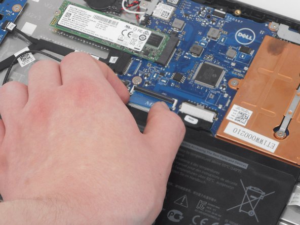

  4. Dell Latitude 3189 Keyboard Replacement: crwdns2935265:04crwdnd2935265:01crwdnd2935265:03crwdne2935265:0 Dell Latitude 3189 Keyboard Replacement: crwdns2935265:04crwdnd2935265:02crwdnd2935265:03crwdne2935265:0 Dell Latitude 3189 Keyboard Replacement: crwdns2935265:04crwdnd2935265:03crwdnd2935265:03crwdne2935265:0
    • Before performing any operations within the laptop, unplug the battery.
    • Pull the white battery connector directly out of its motherboard port.
    • Do not pull on the wires.

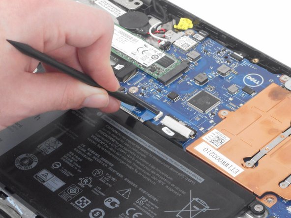

  5. Dell Latitude 3189 Keyboard Replacement, Keyboard: crwdns2935265:05crwdnd2935265:01crwdnd2935265:03crwdne2935265:0 Dell Latitude 3189 Keyboard Replacement, Keyboard: crwdns2935265:05crwdnd2935265:02crwdnd2935265:03crwdne2935265:0 Dell Latitude 3189 Keyboard Replacement, Keyboard: crwdns2935265:05crwdnd2935265:03crwdnd2935265:03crwdne2935265:0
    • Flip up the black lock bar on the ZIF connector with a plastic spudger.
    • Make sure to only lift the flap and not the connector socket because the socket easily breaks off.
    • Gently pull the ribbon cable directly out of its socket.
    • This should require almost no force.
