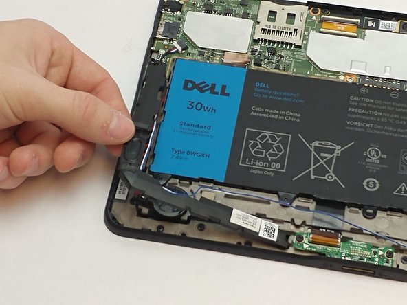

    • Place tablet face-down on flat surface
    • Using the blue opening tool to separate the back plastic cover from the device. Start in a corner, and work your way around the tablet.
  2. Dell Latitude 10-ST2e Speaker Replacement: crwdns2935265:02crwdnd2935265:01crwdnd2935265:03crwdne2935265:0 Dell Latitude 10-ST2e Speaker Replacement: crwdns2935265:02crwdnd2935265:02crwdnd2935265:03crwdne2935265:0 Dell Latitude 10-ST2e Speaker Replacement: crwdns2935265:02crwdnd2935265:03crwdnd2935265:03crwdne2935265:0
    • Using aJIS #00 screwdriver locate and remove the two 3.5mm screws by the plastic covers on left and right side of the tablet
  3. Dell Latitude 10-ST2e Speaker Replacement: crwdns2935265:03crwdnd2935265:01crwdnd2935265:02crwdne2935265:0 Dell Latitude 10-ST2e Speaker Replacement: crwdns2935265:03crwdnd2935265:02crwdnd2935265:02crwdne2935265:0
    • Using the blue opening tool to gently remove the wire connecting the speaker to motherboard
  4. Dell Latitude 10-ST2e Speaker Replacement: crwdns2935265:04crwdnd2935265:01crwdnd2935265:02crwdne2935265:0 Dell Latitude 10-ST2e Speaker Replacement: crwdns2935265:04crwdnd2935265:02crwdnd2935265:02crwdne2935265:0
    • Use the blue opening tool to lift up the speaker counterclockwise from the corner. As you lift up, the speaker will release from the casing. Repeat this process for the second speaker.
  5. Dell Latitude 10-ST2e Speaker Replacement: crwdns2935265:05crwdnd2935265:01crwdnd2935265:01crwdne2935265:0
    • Use tweezers to help lift the white and blue wires connecting both speakers.
  6. Dell Latitude 10-ST2e Speaker Replacement: crwdns2935265:06crwdnd2935265:01crwdnd2935265:02crwdne2935265:0 Dell Latitude 10-ST2e Speaker Replacement: crwdns2935265:06crwdnd2935265:02crwdnd2935265:02crwdne2935265:0
    • Grab both speakers and gently lift up to remove them from the tablet.
