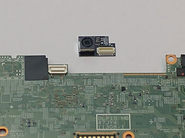

    • Rotate the motherboard upwards from the tablet using tweezers, but do not remove completely from the device. As you lift, disconnect the black and red wire located underneath the motherboard before removing it completely from the tablet.
  11. Dell Latitude 10-ST2e Rear Facing Camera Replacement, Rear Facing Camera: crwdns2935265:011crwdnd2935265:01crwdnd2935265:03crwdne2935265:0 Dell Latitude 10-ST2e Rear Facing Camera Replacement, Rear Facing Camera: crwdns2935265:011crwdnd2935265:02crwdnd2935265:03crwdne2935265:0 Dell Latitude 10-ST2e Rear Facing Camera Replacement, Rear Facing Camera: crwdns2935265:011crwdnd2935265:03crwdnd2935265:03crwdne2935265:0

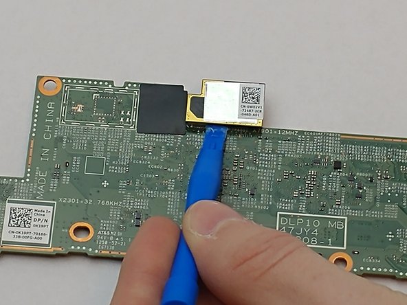

    • Once the motherboard is removed, place on a flat surface facing down. Use the plastic opening tool to disconnect and remove the camera from the motherboard.
