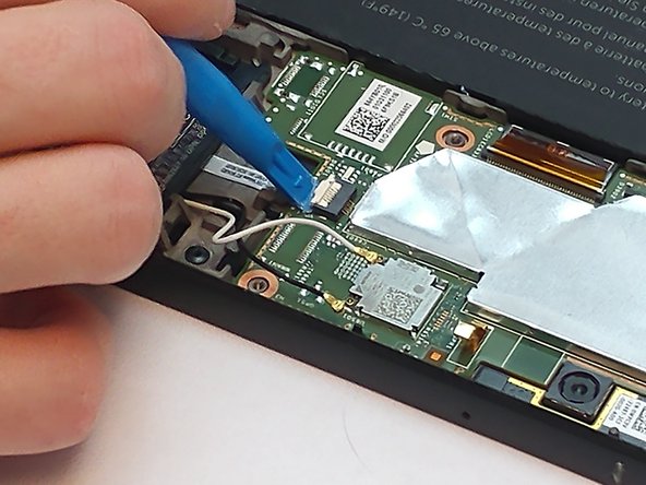

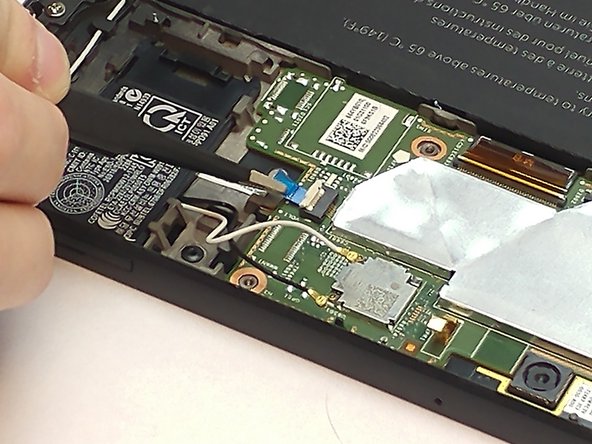

  5. Dell Latitude 10-ST2e Motherboard Replacement: crwdns2935265:05crwdnd2935265:01crwdnd2935265:03crwdne2935265:0 Dell Latitude 10-ST2e Motherboard Replacement: crwdns2935265:05crwdnd2935265:02crwdnd2935265:03crwdne2935265:0 Dell Latitude 10-ST2e Motherboard Replacement: crwdns2935265:05crwdnd2935265:03crwdnd2935265:03crwdne2935265:0
    • Using an opening tool, lift upwards on the white clamp, and pull the blue tab out of the connection with tweezers.

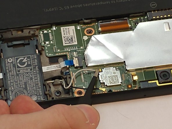

  6. Dell Latitude 10-ST2e Motherboard Replacement: crwdns2935265:06crwdnd2935265:01crwdnd2935265:02crwdne2935265:0 Dell Latitude 10-ST2e Motherboard Replacement: crwdns2935265:06crwdnd2935265:02crwdnd2935265:02crwdne2935265:0
    • Using tweezers, disconnect the white and black wires from the bottom of the motherboard.
    • Pull upwards while holding the brass connections. Do not pull on the wires.

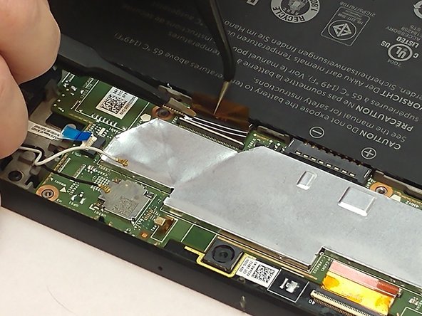

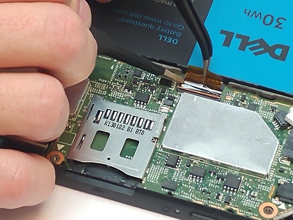

  7. Dell Latitude 10-ST2e Motherboard Replacement: crwdns2935265:07crwdnd2935265:01crwdnd2935265:03crwdne2935265:0 Dell Latitude 10-ST2e Motherboard Replacement: crwdns2935265:07crwdnd2935265:02crwdnd2935265:03crwdne2935265:0 Dell Latitude 10-ST2e Motherboard Replacement: crwdns2935265:07crwdnd2935265:03crwdnd2935265:03crwdne2935265:0
    • Disconnect the two clamps, one orange and one white, using tweezers next to the battery.

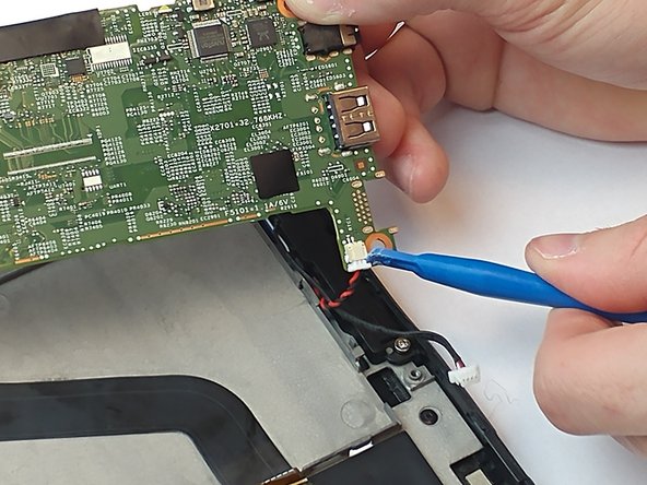

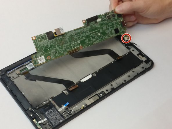

  10. Dell Latitude 10-ST2e Motherboard Replacement: crwdns2935265:010crwdnd2935265:01crwdnd2935265:03crwdne2935265:0 Dell Latitude 10-ST2e Motherboard Replacement: crwdns2935265:010crwdnd2935265:02crwdnd2935265:03crwdne2935265:0 Dell Latitude 10-ST2e Motherboard Replacement: crwdns2935265:010crwdnd2935265:03crwdnd2935265:03crwdne2935265:0
    • Rotate the motherboard upwards from the tablet using tweezers, but do not remove completely from the device. As you lift, disconnect the black and red wire located underneath the motherboard before removing it completely from the tablet.
