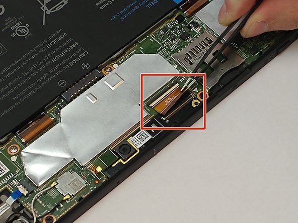

    • Using a JIS #00 screwdriver, remove the one 4.0mm screw securing the camera to the motherboard.
  3. Dell Latitude 10-ST2e Front Facing Camera Replacement: crwdns2935265:03crwdnd2935265:01crwdnd2935265:02crwdne2935265:0 Dell Latitude 10-ST2e Front Facing Camera Replacement: crwdns2935265:03crwdnd2935265:02crwdnd2935265:02crwdne2935265:0
    • Use an opening tool to release the black clamp. With the tweezers gently lift and disconnect the motherboad from the camera.
  4. Dell Latitude 10-ST2e Front Facing Camera Replacement: crwdns2935265:04crwdnd2935265:01crwdnd2935265:02crwdne2935265:0 Dell Latitude 10-ST2e Front Facing Camera Replacement: crwdns2935265:04crwdnd2935265:02crwdnd2935265:02crwdne2935265:0

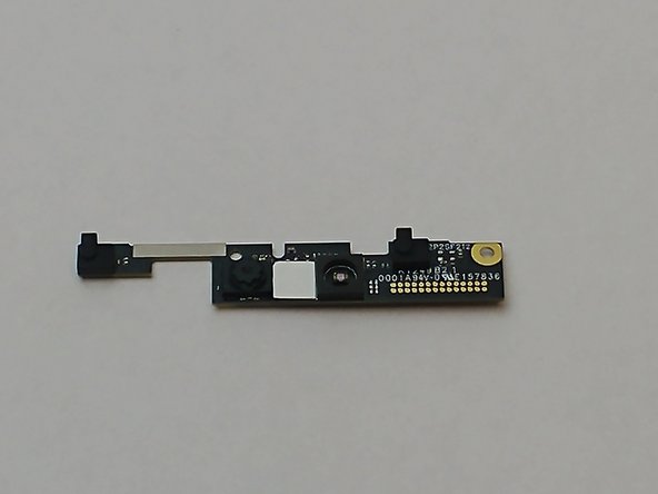

    • Gently lift up the camera using the plastic opening tool and remove it from the tablet.
