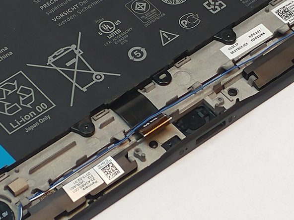

    • Remove the backplate of the tablet by using the plastic opening tool to lift it up.
  2. Dell Latitude 10-ST2e Charging Port Replacement: crwdns2935265:02crwdnd2935265:01crwdnd2935265:02crwdne2935265:0 Dell Latitude 10-ST2e Charging Port Replacement: crwdns2935265:02crwdnd2935265:02crwdnd2935265:02crwdne2935265:0
    • Using a JIS #00 screwdriver, remove the two 4.0mm screws securing it to the motherboard.
  3. Dell Latitude 10-ST2e Charging Port Replacement: crwdns2935265:03crwdnd2935265:01crwdnd2935265:02crwdne2935265:0 Dell Latitude 10-ST2e Charging Port Replacement: crwdns2935265:03crwdnd2935265:02crwdnd2935265:02crwdne2935265:0
    • Lift up the orange clamp connecting the black DOC B/D cable to the charging board.
  4. Dell Latitude 10-ST2e Charging Port Replacement: crwdns2935265:04crwdnd2935265:01crwdnd2935265:03crwdne2935265:0 Dell Latitude 10-ST2e Charging Port Replacement: crwdns2935265:04crwdnd2935265:02crwdnd2935265:03crwdne2935265:0 Dell Latitude 10-ST2e Charging Port Replacement: crwdns2935265:04crwdnd2935265:03crwdnd2935265:03crwdne2935265:0
    • Place the opening tool underneath the charging board, lift up, and slide it out the charging port, along with its board.
