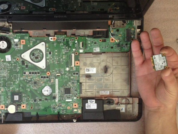

    • Switch off the laptop and remove the battery.
    • The keyboard is held by 4x locking clips.
    • By using cutter, carefully lift up the one side of the keyboard and start opening the locking clips.
  2. Dell Inspiron N5110 - WiFi Half Mini PCI card Replacement: crwdns2935265:02crwdnd2935265:01crwdnd2935265:03crwdne2935265:0 Dell Inspiron N5110 - WiFi Half Mini PCI card Replacement: crwdns2935265:02crwdnd2935265:02crwdnd2935265:03crwdne2935265:0 Dell Inspiron N5110 - WiFi Half Mini PCI card Replacement: crwdns2935265:02crwdnd2935265:03crwdnd2935265:03crwdne2935265:0
    • Disconnect the keyboard cable and remove the keyboard.
    • Remove the access door screw and the access door
    • Remove the screw securing the optical drive, and remove the optical drive

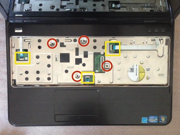

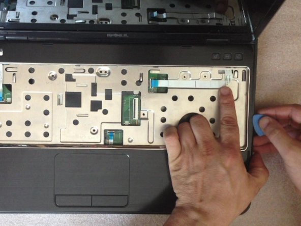

  3. Dell Inspiron N5110 - WiFi Half Mini PCI card Replacement: crwdns2935265:03crwdnd2935265:01crwdnd2935265:03crwdne2935265:0 Dell Inspiron N5110 - WiFi Half Mini PCI card Replacement: crwdns2935265:03crwdnd2935265:02crwdnd2935265:03crwdne2935265:0 Dell Inspiron N5110 - WiFi Half Mini PCI card Replacement: crwdns2935265:03crwdnd2935265:03crwdnd2935265:03crwdne2935265:0
    • Remove all the screws
    • Pry the upper plastic casing off of the laptop
