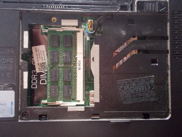

  4. Dell Inspiron N4110 RAM Replacement, RAM: crwdns2935265:04crwdnd2935265:01crwdnd2935265:02crwdne2935265:0 Dell Inspiron N4110 RAM Replacement, RAM: crwdns2935265:04crwdnd2935265:02crwdnd2935265:02crwdne2935265:0
    • Locate and unscrew the one 2.5x5 mm screw on the cover.
    • The screw does not detach from the cover. Make sure the screw is fully unscrewed before attempting to remove the cover.
  5. Dell Inspiron N4110 RAM Replacement: crwdns2935265:05crwdnd2935265:01crwdnd2935265:02crwdne2935265:0 Dell Inspiron N4110 RAM Replacement: crwdns2935265:05crwdnd2935265:02crwdnd2935265:02crwdne2935265:0
    • Remove RAM cover from the laptop.
  6. Dell Inspiron N4110 RAM Replacement: crwdns2935265:06crwdnd2935265:01crwdnd2935265:02crwdne2935265:0 Dell Inspiron N4110 RAM Replacement: crwdns2935265:06crwdnd2935265:02crwdnd2935265:02crwdne2935265:0
    • Use your fingers to separate the two metal clips from the RAM.
    • The RAM will lift up when properly separated. Do not force the RAM out of the clips.
  7. Dell Inspiron N4110 RAM Replacement: crwdns2935265:07crwdnd2935265:01crwdnd2935265:01crwdne2935265:0
    • Remove the RAM from the computer.
    • Be careful as to not touch the metal on the bottom of the RAM. This can cause damage.
    • The RAM should be placed on a non-conductive surface.
