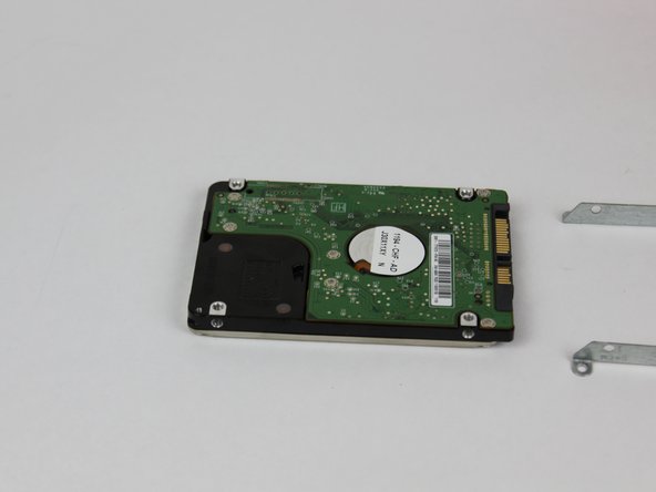

  23. Dell Inspiron N4010 Hard Disk Drive Replacement: crwdns2935265:024crwdnd2935265:01crwdnd2935265:01crwdne2935265:0
    • Undo the 2 screws with the #0 Phillips head driver on either side of the hard drive assembly.
  24. Dell Inspiron N4010 Hard Disk Drive Replacement: crwdns2935265:025crwdnd2935265:01crwdnd2935265:02crwdne2935265:0 Dell Inspiron N4010 Hard Disk Drive Replacement: crwdns2935265:025crwdnd2935265:02crwdnd2935265:02crwdne2935265:0
    • Slide the assembly off of the hard drive.
