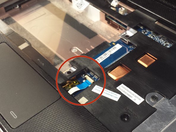

    • Orient the device so that it is facing top side up with the device open.
    • Lift up the lock tab that holds in the ribbon connecting the track pad to the computer using your finger nail or the plastic spudger.
    • Pull ribbon to disconnect the blue half but leave the ribbon connected to the device at the other end.
    • When placing the ribbon back in its location pull up on the lock tab, slide the blue end of the ribbon in, and push the lock tab down to secure the ribbon in place.

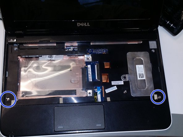

    • Remove the three screws remaining underneath the keyboard using the same screw driver as before. (Not the black screw highlighted in yellow).
    • The screws are different sizes, be sure to make note of where each screw goes.
    • Remove the two screws at the front corners of the keyboard. They are highlighted in light blue.

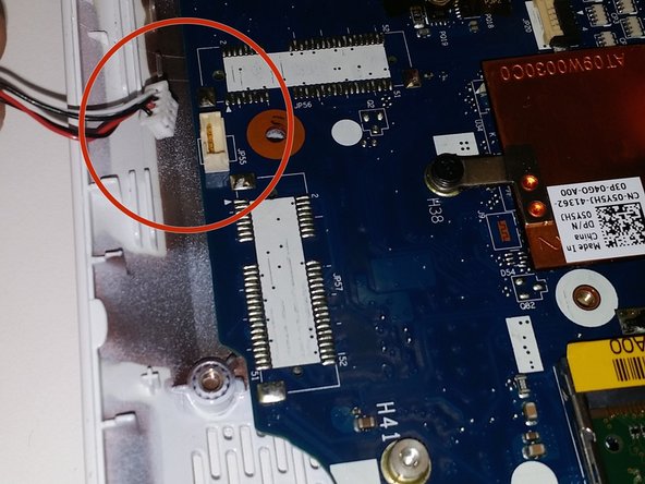

    • Use a plastic spudger to remove the outer frame of the laptop. Once the spudger is between the outer frame and the laptop slide it along this seam all the way to the screen in both directions.
    • Once the outer frame is loose it will still be attached by a wire connection. To detach the outer frame completely, set the frame back in place and pull gently on the wires while using your finger nail to pop the white upper section of the tan box upward until it comes out.
    • When putting the outer frame back in place lay the frame down on the device in its correct location and orientation. Then re-attach the wires. Finally, push the outer frame downward until it clicks back into place.

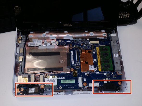

    • Remove the screws holding the two speakers using the same screw driver as before. The speakers are located on the track pad side of the laptop and are highlighted in red.
    • Each speaker has two screws.

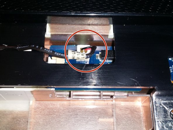

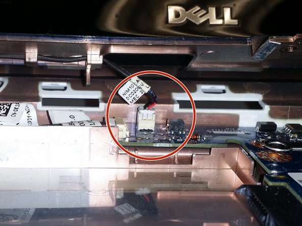

    • Remove the speakers by pulling them upward gently. There are speaker wires that will still be attached to the circuit board.
    • To remove the speaker wires from the circuit board trace the wires to where they connect to the tan box. Using your finger nail or the plastic spudger pull gently on the wires and lift the white upper section of the tan box upward until it pops out.
    • When placing the new speakers in place be sure to attach the wires first.
