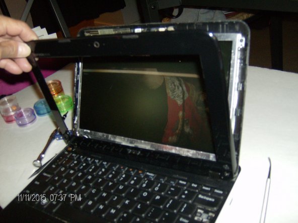

    • Remove the two rubber pieces at the bottom of the screen and remove the screws located behind them.
    • Carefully remove the plastic casing from the device.

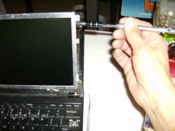

    • Remove the four screws on each corner of the screen. Then remove the screws located on the side of the screen.

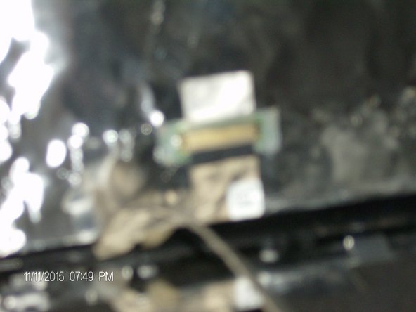

    • Carefully unplug the ribbon on the back of the screen.

    • Place the new screen onto the device and plug the ribbon in.
    • Replace the screws on the side of the screen.

    • Snap on the plastic screen cover and replace the two screws and the rubber pieces at the bottom of the screen.
