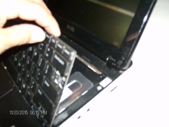

    • Insert the spudger between the top of the keyboard and the laptop body.
    • Carefully pry the keyboard up.
    • Be gentle! You don't want to damage the laptops ribbon cable connector by pulling too hard.
    • It's not recommended to use a metal spudger for this repair as the photo shows. A regular nylon spudger will work just fine.

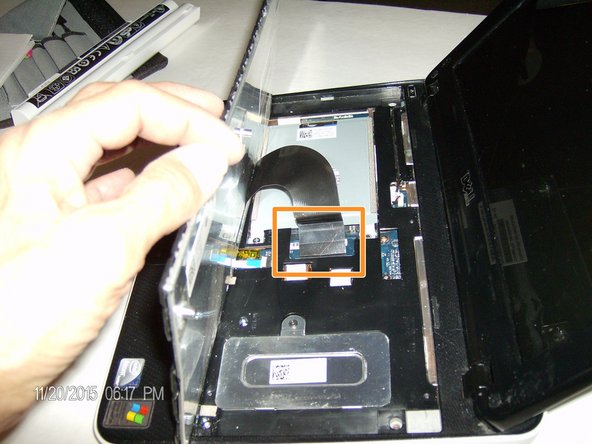

    • Unlock the connector to release the ribbon cable.
    • Carefully pull on the clear tab to remove the keyboard from the device.
