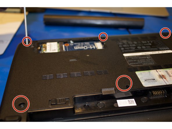

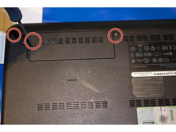

  2. Dell Inspiron Mini 1012 Hard Drive Replacement, Remove back screws: crwdns2935265:02crwdnd2935265:01crwdnd2935265:03crwdne2935265:0 Dell Inspiron Mini 1012 Hard Drive Replacement, Remove back screws: crwdns2935265:02crwdnd2935265:02crwdnd2935265:03crwdne2935265:0 Dell Inspiron Mini 1012 Hard Drive Replacement, Remove back screws: crwdns2935265:02crwdnd2935265:03crwdnd2935265:03crwdne2935265:0
    • Remove the 3 screws highlighted in red that secure the keyboard to the case using the screw driver with largest phillips head in the box. Make sure to keep the screws separated by step to ensure that they can be put back in the correct location when reversing the steps.

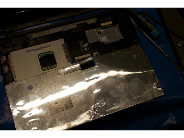

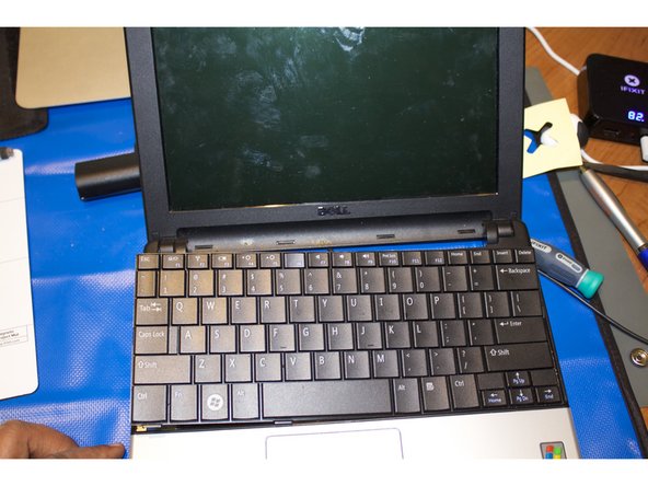

  3. Dell Inspiron Mini 1012 Hard Drive Replacement, Remove Keyboard: crwdns2935265:03crwdnd2935265:01crwdnd2935265:03crwdne2935265:0 Dell Inspiron Mini 1012 Hard Drive Replacement, Remove Keyboard: crwdns2935265:03crwdnd2935265:02crwdnd2935265:03crwdne2935265:0 Dell Inspiron Mini 1012 Hard Drive Replacement, Remove Keyboard: crwdns2935265:03crwdnd2935265:03crwdnd2935265:03crwdne2935265:0
    • Turn the device right side up and open the device to view the keyboard.
    • Remove the keyboard away from the case, using a plastic spudger if necessary.
    • The keyboard will still be attached to the motherboard by a ribbon cable.

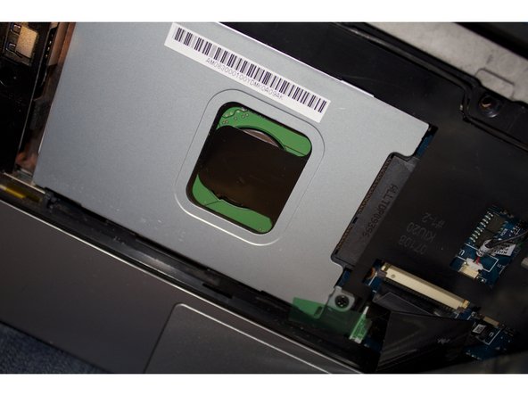

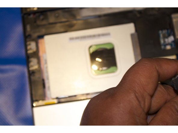

  4. Dell Inspiron Mini 1012 Hard Drive Replacement, Remove Hard drive: crwdns2935265:04crwdnd2935265:01crwdnd2935265:03crwdne2935265:0 Dell Inspiron Mini 1012 Hard Drive Replacement, Remove Hard drive: crwdns2935265:04crwdnd2935265:02crwdnd2935265:03crwdne2935265:0 Dell Inspiron Mini 1012 Hard Drive Replacement, Remove Hard drive: crwdns2935265:04crwdnd2935265:03crwdnd2935265:03crwdne2935265:0
    • Remove the 2 Phillips head screws securing hard drive to case. Use the same screw driver bit as before
    • Pull the plastic tab connected to the hard drive outward in the left hand direction to remove hard drive from case.
    • When putting the hard drive back slide it in to the space so that the screw holes line up and press down until there is a snug fit.

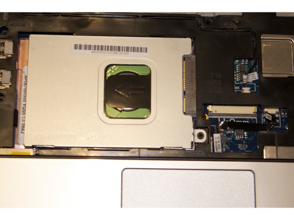

  5. Dell Inspiron Mini 1012 Hard Drive Replacement, Add new hard drive: crwdns2935265:05crwdnd2935265:01crwdnd2935265:03crwdne2935265:0 Dell Inspiron Mini 1012 Hard Drive Replacement, Add new hard drive: crwdns2935265:05crwdnd2935265:02crwdnd2935265:03crwdne2935265:0 Dell Inspiron Mini 1012 Hard Drive Replacement, Add new hard drive: crwdns2935265:05crwdnd2935265:03crwdnd2935265:03crwdne2935265:0
    • Add a new hard drive

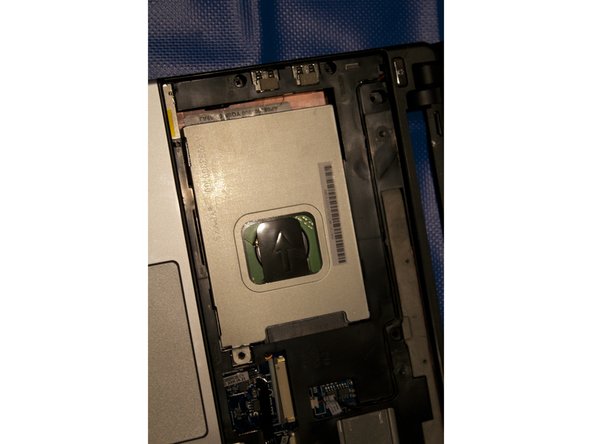

  6. Dell Inspiron Mini 1012 Hard Drive Replacement, Apply back the keyboard: crwdns2935265:06crwdnd2935265:01crwdnd2935265:01crwdne2935265:0
    • Insert the ribbon for keyboard back into the motherboard.
    • Than snap keyboard back into place
