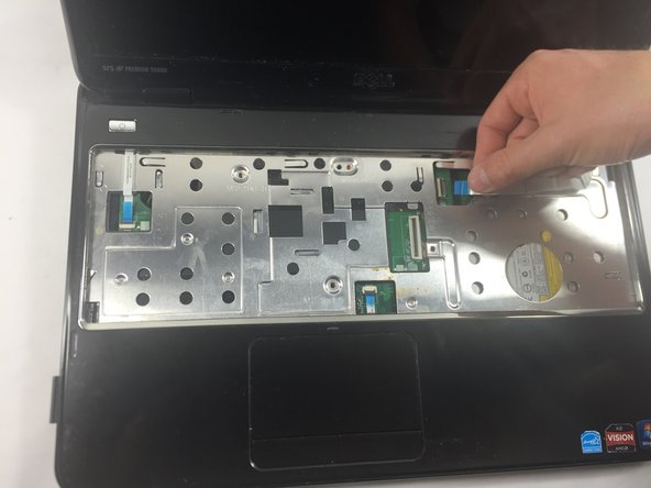

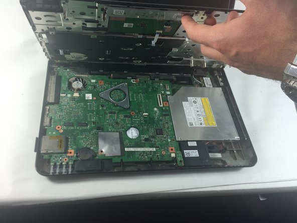

    • Turn the computer over and open the display as far as possible and remove the four 5 mm Phillips # 0 screw holding the palmrest in place.
  16. Dell Inspiron M5110 Hard Drive Replacement: crwdns2935265:016crwdnd2935265:01crwdnd2935265:02crwdne2935265:0 Dell Inspiron M5110 Hard Drive Replacement: crwdns2935265:016crwdnd2935265:02crwdnd2935265:02crwdne2935265:0
    • Disconnect the power button board cable, touch pad cable and the hot key board cable from the connectors.
  17. Dell Inspiron M5110 Hard Drive Replacement: crwdns2935265:017crwdnd2935265:01crwdnd2935265:02crwdne2935265:0 Dell Inspiron M5110 Hard Drive Replacement: crwdns2935265:017crwdnd2935265:02crwdnd2935265:02crwdne2935265:0
    • Use a plastic opening tool to carefully pry out the palmrest assembly and lift it off the computer base.

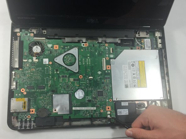

    • Unscrew the five 5 mm Phillips # 0 screws located in the red circles, found on the system board.
  19. Dell Inspiron M5110 Hard Drive Replacement: crwdns2935265:019crwdnd2935265:01crwdnd2935265:02crwdne2935265:0 Dell Inspiron M5110 Hard Drive Replacement: crwdns2935265:019crwdnd2935265:02crwdnd2935265:02crwdne2935265:0
    • Unplug the small, green, rectangular Bluetooth receptor chip attached towards the bottom right hand corner of the system board.
    • Grasp the chip by placing your forefinger under the chip and thumb on the top, lightly pulling the chip upwards away from the device.
  20. Dell Inspiron M5110 Hard Drive Replacement: crwdns2935265:020crwdnd2935265:01crwdnd2935265:02crwdne2935265:0 Dell Inspiron M5110 Hard Drive Replacement: crwdns2935265:020crwdnd2935265:02crwdnd2935265:02crwdne2935265:0
    • Unplug the small white cable connected to the speaker in the lower right hand corner of the device.
    • Use tweezers to unplug the cable if it is hard to remove by hand or if you cannot grasp it.

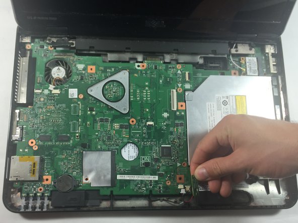

    • Remove the system board from the laptop.
    • Disconnect the two minor boards, the VGA/Power Board on the left, and the I/O Board on the right, attatched to the system board.
    • Flip the system board over revealing the fan compartment and the hard drive.
