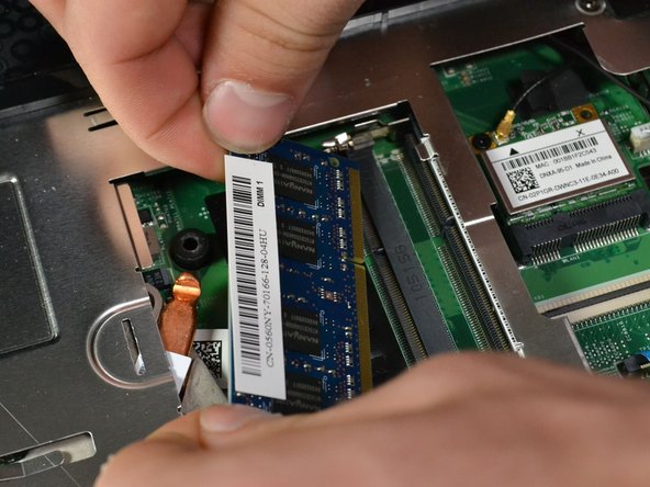

  5. Dell Inspiron M5030 RAM Replacement, RAM: crwdns2935265:05crwdnd2935265:01crwdnd2935265:03crwdne2935265:0 Dell Inspiron M5030 RAM Replacement, RAM: crwdns2935265:05crwdnd2935265:02crwdnd2935265:03crwdne2935265:0 Dell Inspiron M5030 RAM Replacement, RAM: crwdns2935265:05crwdnd2935265:03crwdnd2935265:03crwdne2935265:0
    • Locate the two blue chips in the middle of the computer. These are the computer's RAM (Random Access Memory) chips.
    • Push outward on the metal tabs on the short ends of the upper RAM chip to loosen it. The left end of the chip should lift up, putting the chip at an angle.
    • Grab the lifted left edge of the RAM with your fingers, and gently slide it out.
  6. Dell Inspiron M5030 RAM Replacement: crwdns2935265:06crwdnd2935265:01crwdnd2935265:03crwdne2935265:0 Dell Inspiron M5030 RAM Replacement: crwdns2935265:06crwdnd2935265:02crwdnd2935265:03crwdne2935265:0 Dell Inspiron M5030 RAM Replacement: crwdns2935265:06crwdnd2935265:03crwdnd2935265:03crwdne2935265:0
    • Push outward on the metal tabs on the short ends of the lower RAM chip to loosen it. The left end of the chip should lift up, putting the chip at an angle.
