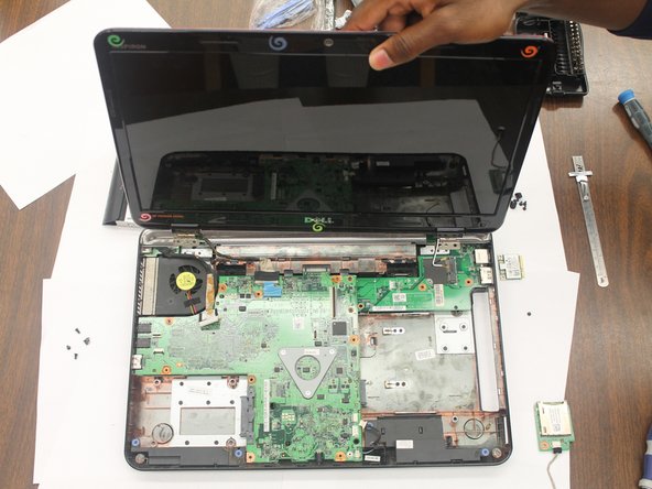

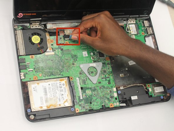

    • Unplug the Wireless Antenna cables.
  17. Dell Inspiron M5010 Fan/Heatsink Replacement: crwdns2935265:017crwdnd2935265:01crwdnd2935265:03crwdne2935265:0 Dell Inspiron M5010 Fan/Heatsink Replacement: crwdns2935265:017crwdnd2935265:02crwdnd2935265:03crwdne2935265:0 Dell Inspiron M5010 Fan/Heatsink Replacement: crwdns2935265:017crwdnd2935265:03crwdnd2935265:03crwdne2935265:0
    • Unplug the LCD cable.
    • Lift the screen from the computer.
  18. Dell Inspiron M5010 Fan/Heatsink Replacement: crwdns2935265:018crwdnd2935265:01crwdnd2935265:01crwdne2935265:0
    • Remove the Middle Cover.
  19. Dell Inspiron M5010 Fan/Heatsink Replacement: crwdns2935265:019crwdnd2935265:01crwdnd2935265:01crwdne2935265:0
    • Remove the Motherboard.
