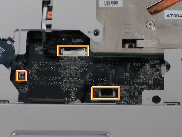

  11. Dell Inspiron E1705 Motherboard Replacement: crwdns2935265:011crwdnd2935265:01crwdnd2935265:03crwdne2935265:0 Dell Inspiron E1705 Motherboard Replacement: crwdns2935265:011crwdnd2935265:02crwdnd2935265:03crwdne2935265:0 Dell Inspiron E1705 Motherboard Replacement: crwdns2935265:011crwdnd2935265:03crwdnd2935265:03crwdne2935265:0
    • Using a Phillips head screwdriver, remove the screws shown in the image. They all have the letter "P" next to them.
    • Carefully unplug the connections shown.
    • Don't forget the display cable. It is slightly to the right of the Dell logo at the top.
    • Also, the wireless cables on the right side may prevent moving the upper case out of the way.
    • Once the screws have been removed and the connections unplugged, use the plastic opening tool to gently separate the panel from the lower case.
