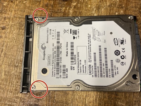

  2. Dell Inspiron E1505 Hard drive Replacement, Removing the drive: crwdns2935265:02crwdnd2935265:01crwdnd2935265:03crwdne2935265:0 Dell Inspiron E1505 Hard drive Replacement, Removing the drive: crwdns2935265:02crwdnd2935265:02crwdnd2935265:03crwdne2935265:0 Dell Inspiron E1505 Hard drive Replacement, Removing the drive: crwdns2935265:02crwdnd2935265:03crwdnd2935265:03crwdne2935265:0
    • Remove the two screws holding the drive to the bottom panel.
    • Slide the hard drive out of the laptop.
    • The hard drive is fragile, please handle it with care.

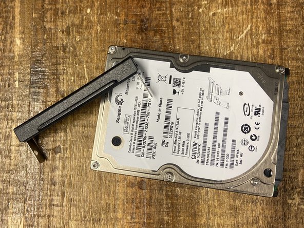

  3. Dell Inspiron E1505 Hard drive Replacement, Hard drive bracket: crwdns2935265:03crwdnd2935265:01crwdnd2935265:03crwdne2935265:0 Dell Inspiron E1505 Hard drive Replacement, Hard drive bracket: crwdns2935265:03crwdnd2935265:02crwdnd2935265:03crwdne2935265:0 Dell Inspiron E1505 Hard drive Replacement, Hard drive bracket: crwdns2935265:03crwdnd2935265:03crwdnd2935265:03crwdne2935265:0
    • Remove screws from the cosmetic bracket.
    • Attach bracket to new hard drive. (if applicable)
