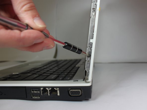

  3. Dell Inspiron E1405 LCD Screen Replacement, LCD Screen: crwdns2935265:03crwdnd2935265:01crwdnd2935265:03crwdne2935265:0 Dell Inspiron E1405 LCD Screen Replacement, LCD Screen: crwdns2935265:03crwdnd2935265:02crwdnd2935265:03crwdne2935265:0 Dell Inspiron E1405 LCD Screen Replacement, LCD Screen: crwdns2935265:03crwdnd2935265:03crwdnd2935265:03crwdne2935265:0
    • Use your fingers or a spudger to remove the six small rubber covers off the display assembly.
    • Remove the six 5.7 mm screws with a Phillips #00 screwdriver.

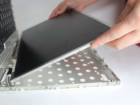

  5. Dell Inspiron E1405 LCD Screen Replacement: crwdns2935265:05crwdnd2935265:01crwdnd2935265:03crwdne2935265:0 Dell Inspiron E1405 LCD Screen Replacement: crwdns2935265:05crwdnd2935265:02crwdnd2935265:03crwdne2935265:0 Dell Inspiron E1405 LCD Screen Replacement: crwdns2935265:05crwdnd2935265:03crwdnd2935265:03crwdne2935265:0
    • Remove the three 3.6 mm screws using a Phillips #00 screwdriver on both sides of the display.
    • Remove the LCD screen from the display assembly.

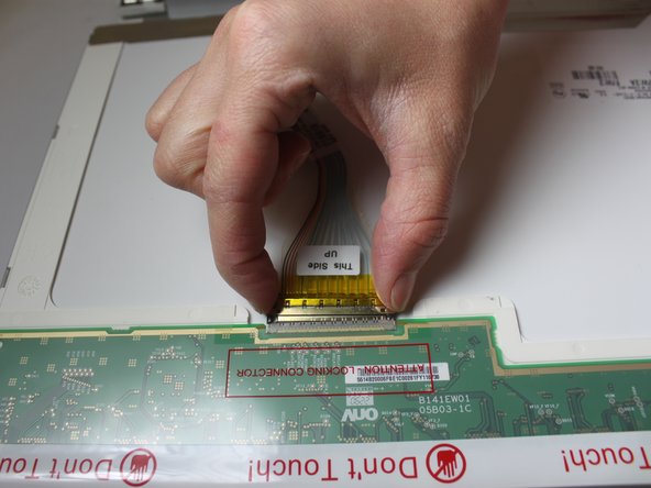

  6. Dell Inspiron E1405 LCD Screen Replacement: crwdns2935265:06crwdnd2935265:01crwdnd2935265:02crwdne2935265:0 Dell Inspiron E1405 LCD Screen Replacement: crwdns2935265:06crwdnd2935265:02crwdnd2935265:02crwdne2935265:0
    • Unplug the VGA cable by pushing the two metal sides towards the middle of the strip.
    • Gently pull the VGA cable away to release the strip.
  7. Dell Inspiron E1405 LCD Screen Replacement: crwdns2935265:07crwdnd2935265:01crwdnd2935265:02crwdne2935265:0 Dell Inspiron E1405 LCD Screen Replacement: crwdns2935265:07crwdnd2935265:02crwdnd2935265:02crwdne2935265:0
    • Remove the next connection by pressing the two metal sides towards the middle. Then gently pull up the ribbon.
