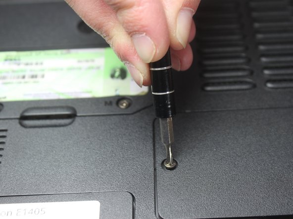

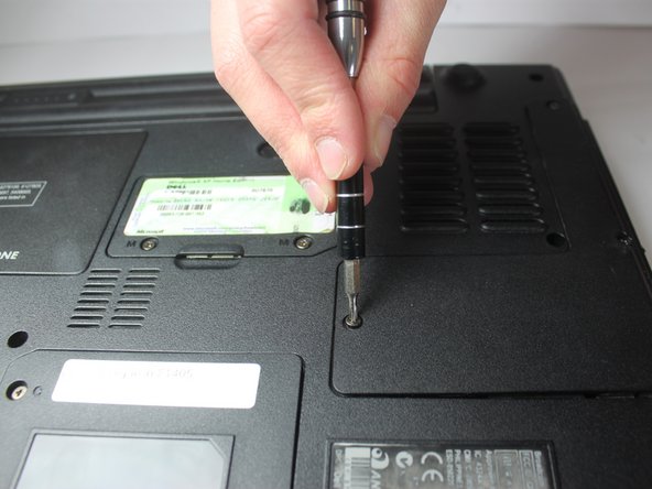

    • Remove/loosen the eight 4.8mm screws with a #1 Phillips screwdriver securing the bottom panel.
    • Remove the bottom panel.
