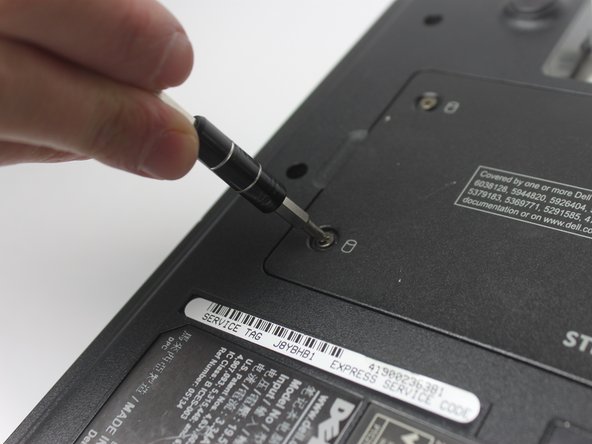

  3. Dell Inspiron E1405 Hard Drive Replacement, Hard Drive: crwdns2935265:03crwdnd2935265:01crwdnd2935265:02crwdne2935265:0 Dell Inspiron E1405 Hard Drive Replacement, Hard Drive: crwdns2935265:03crwdnd2935265:02crwdnd2935265:02crwdne2935265:0
    • Locate the hard drive access door.
    • Remove the two 5.5mm screws with a #00 Phillips screwdriver. These screws are securing the hard drive access door.
  4. Dell Inspiron E1405 Hard Drive Replacement: crwdns2935265:04crwdnd2935265:01crwdnd2935265:02crwdne2935265:0 Dell Inspiron E1405 Hard Drive Replacement: crwdns2935265:04crwdnd2935265:02crwdnd2935265:02crwdne2935265:0
    • Using your fingers, open and remove the access door from the laptop, exposing the hard drive underneath.
