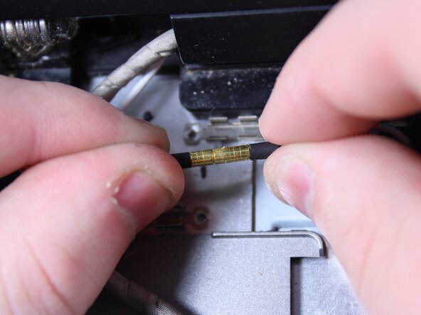

    1. Dell Inspiron B130 Screen Replacement, Screen: crwdns2935265:08crwdnd2935265:01crwdnd2935265:02crwdne2935265:0 Dell Inspiron B130 Screen Replacement, Screen: crwdns2935265:08crwdnd2935265:02crwdnd2935265:02crwdne2935265:0
      • Detach the blue display connector.
    2. Dell Inspiron B130 Screen Replacement: crwdns2935265:09crwdnd2935265:01crwdnd2935265:02crwdne2935265:0 Dell Inspiron B130 Screen Replacement: crwdns2935265:09crwdnd2935265:02crwdnd2935265:02crwdne2935265:0
      • Detach the connector by pulling the two ends straight apart.
      • Avoid twisting or pulling at an angle to prevent damage.
